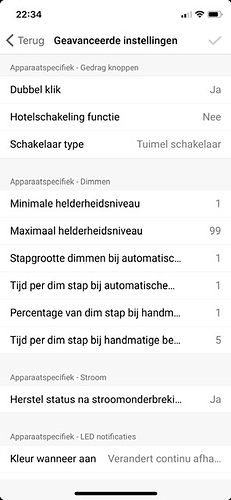

You have to set the parameters 40 and/or 41 in the extended Walli settings (gear wheel) according to your wishes (see manual of the Walli dimmer).
In the screenshot you can see the advanced settings of a Walli Switch.
Your screenshots are not from the WHEN section, right?
Yes the picture above was of the WHEN section of the flow.
But also in the advanced section of the Walli dimmer or the Walli shutter I don’t have parameter 40 or 41 in button behavior. See screenshot enclosed.
I don’t have an Walli switch, so I can’t see if that one is different and has more options.
I think I might do something wrong, but I have no idea what.
