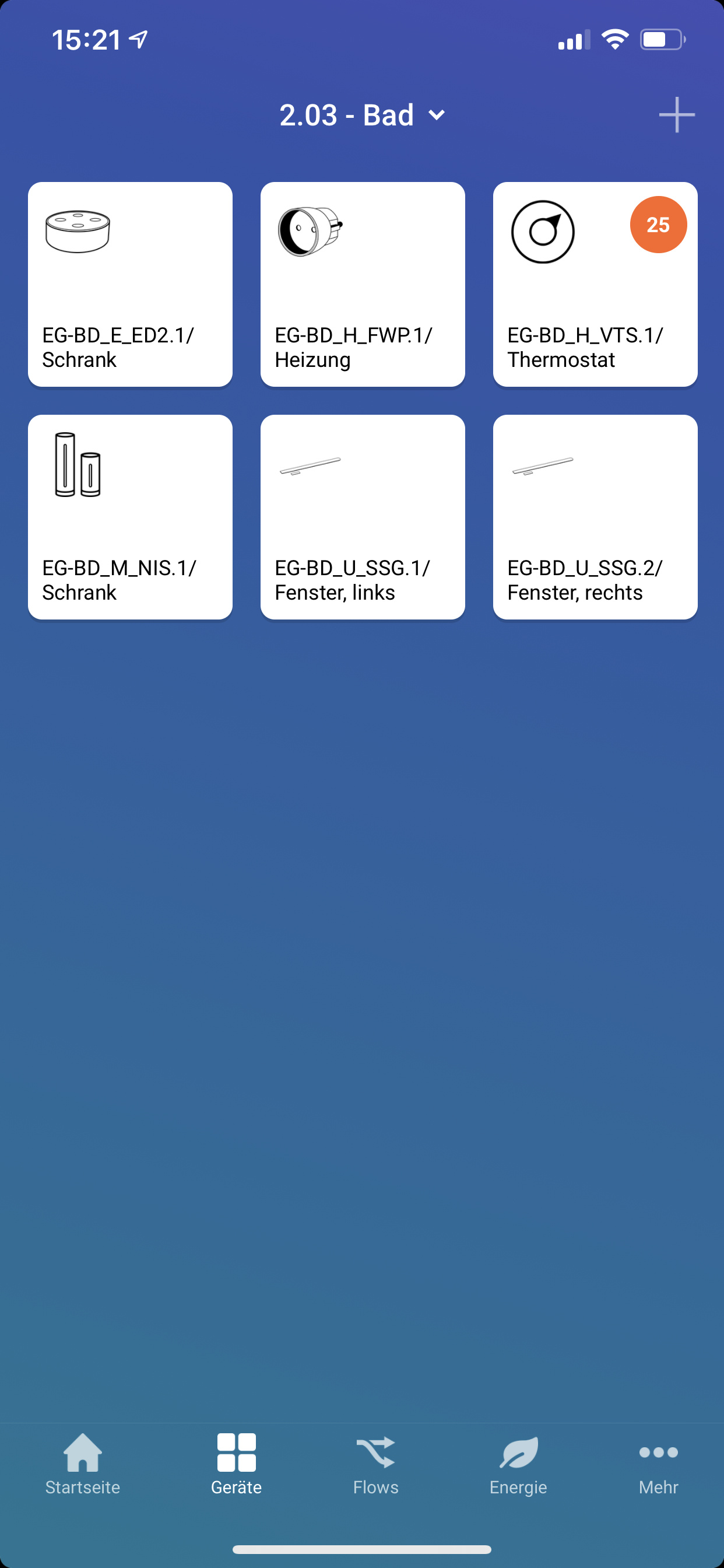

is there a delay within the App between asking the contact sensor (if they have an alarm) and switching the heating?
  1. Heating is off, thermostat 22°, no contact alarm
  2. Thermostat set to 25°, heating went immediately on, no contact alarm
  3. Thermostat set to 25°, contact alarm on, heating still on
Also when I open the second window (suspected all sensors have to report an alarm) the heating stays on.
The heating is turned on by a Fibaro WallPlug (configured as heating).
The contact sensors are Sensative Strips.
I also enabled the “turn off if contact alarm” function in the settings of the thermostat, for sure.

Yes, the VThermo checks other devices (thermometers, thermostatus, contact sensors) every 60 seconds.
So a maximum of 60 seconds before the state of the contact sensor is taken into account.

Hello to the designer of this app,
I have „subzones“ for different kinds of devices in each room, e.g. Sensor, Actuators, Logicals, etc.
So contact sensor are within the sensor subzone and the heating is in the actuators subzone.
The virtual thermostat itself is in the room. Logically the virtual thermostat now can‘t work.
Two questions:
  1. would it be possible to send the temperature to the thermostat with measure_temperatur in the future?
  2. or would it be possible to configure the thermostat to take a look to the subzones where he is located in the zone above?
Regards
Andreas
