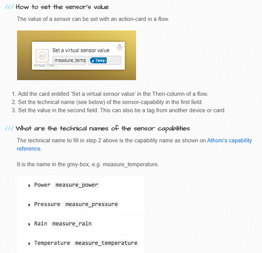

I’m not using the built-in virtual devices, instead I use this app
I tried that app, but I’m unable to set the virtual sensors value. I’m running firmware v5rc50, perhaps the app does not support v5.
I can rest the value from the mqtt topic and use both on a variable and a notification. But the value on the virtual sensor does not set.
Plz show us the card.
The Better Logic variable is set (I’ve confirmed that) and the flow is triggered (the notification is created), but the sensor value is not set.
Set value=measure_power.
Plz do not use tags in the first option of the card but type in manually “measure_power”.
Like also visable in the flow cards from @Henrik_Johnsson.
Thanks, that worked.
