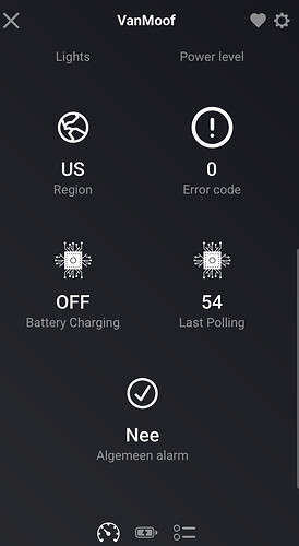

Have installed it and was able to add my SmartBike (as an Electrified, but there isn’t any data (battery status, km’s, etc).
But the app is crashing after some while. Also when I delete my bike and there are no devices for the app.

Installed v1.0.2 but it does not find my bike anymore unfortunately. Deleted the app, re-installed, loggin in again and restarted the app. But it still does not find the bike.
In v1.0.0 it did find the bike when added as Electrified.
Can it have something to do with the following?
Send you a new diagnostic report with number c183b77d-2bdf-4e37-b511-0e8df9a12dbc
