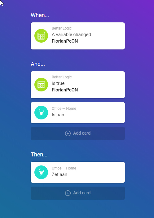

The flow that I’m trying to create is that if my pc is turned on (better logic variable set to true) the light in a room should also turn on if not already on.
Like this:
When I look for the office light, in this case, I can only select the on the state. So in the flow above ‘is on’ should be ‘is off’ Might be missing something here :sweat_smile:
If i am Right: Is ann = Is On, Zet aan = Switch On.
If this is the case the Flow couldn’t work. You are lokking in AND if the Hue-Light is On and in WHEN the Hue-Light should be turned on.
On the Card of the Hue-Light should be an Option “Invert” > Is this given on your Hue-Light? This should be turned on > In AND the Hue-Light becomes “Is not On”. Then it should work.
Perfect! Totally missed that option on the card!:sweat_smile:
Thanks for the help!
