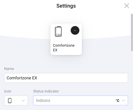

User's choice of status indicator doesn't work
I’m trying to build my first Homey app. I’ve successfully added capabilities that show up on the list of “Status indicator” in the Settings for the device. However, even though I change the setting, the icon still just shows a black circle with a dash, and not the value for the capability that I chose.
Any tips what I might be doing wrong?

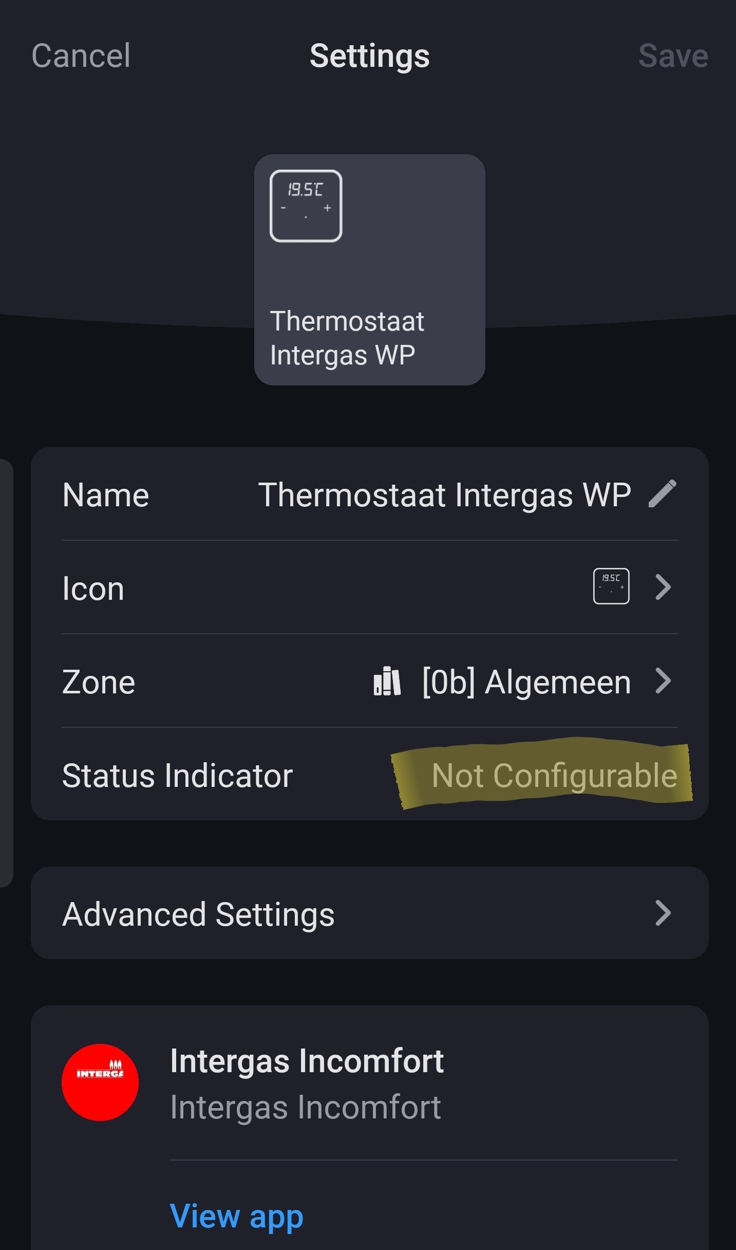

From a user’s POV it’s disabled:

Yeah for thermostats we can change anything for status indicator, but indeed it doesn’t change, and no warning whatsoever. A bit typical for Athom: we’re ought to find the errors & bugs, and so you did :woozy_face::grimacing:

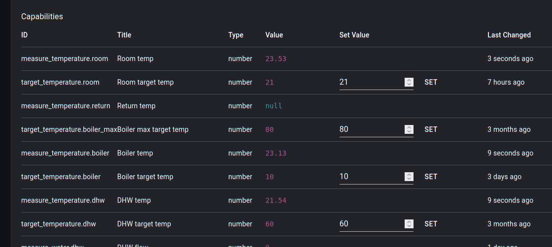

Can you show the devices’ capabilities, when you search for it here:
https://tools.developer.homey.app/tools/devices
I’m looking for an overview like:

Here you go!
I guess my issue with the dash could be that I’m only using sub-capabilities and the number might only use the main capability? [3 min later] Yep, that was it! The status indicator will only show the main capability target_temperature. So Athom is basically forcing me to write code that is difficult to understand, since I have a bunch of temperatures to measure and set in my heat pump. Let’s see how this new heatpump class turns out…

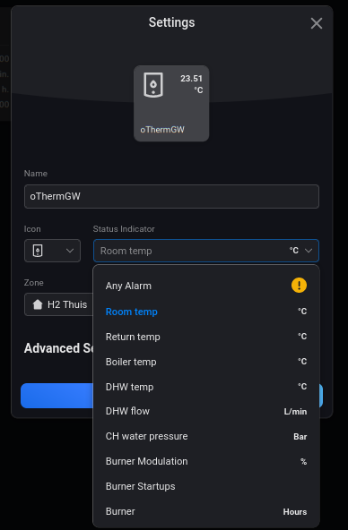

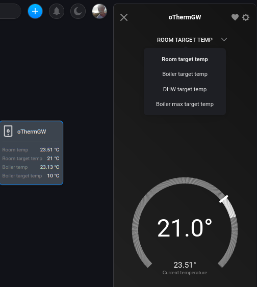

I took a peek at OTGW MQTT app by Robin, it’s just possible to use multiple thermostats using only sub-capabilities.
But, you’d use the class other, and now you can use the status indicator as you wish (now it’s not trying to ‘be’ a thermostat class)
