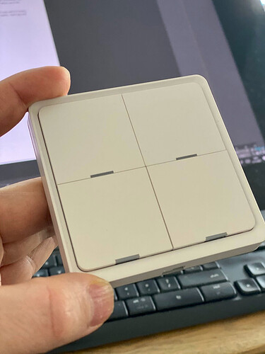

I’ve got a totally weird problem over here, and also looks like quite a security hole. I’ve bought a Tuya 4 switch zigbee unit, and I tried to pair it with my Deconz zigbee receiver without succeeding… But I noticed when I press the top left button once…. EVERY smart pug turns on !?!? When I press the bottom left button every smart plug turns off…. What the….
I didn’t pair it yet to anything. I tried, but deconz did not detect it, and I didn’t even add it to Homey (with Homey Deconz)… This is so weird… Also the smart pug brand does not matter. I have Innr and Ikea smart plugs, en they all turn on / off.
Some plugs aren’t even connected to flows or something.

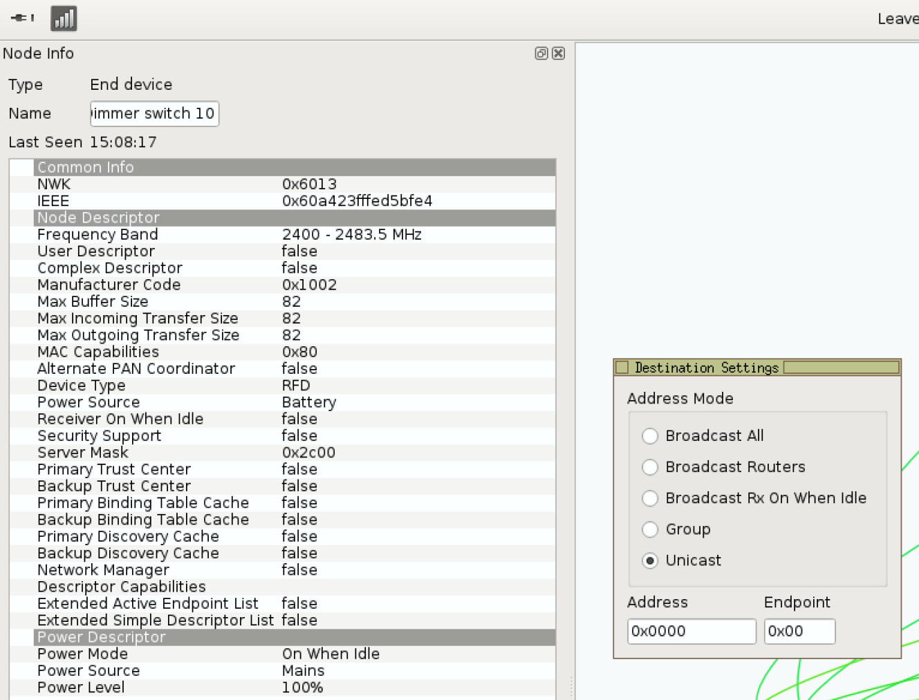

Because it’s likely broadcast one (or more) clusters. In the deCONZ UI, press F6 (or select Edit > Destination Settings) and select all clusters of the node to see if there are any set to Broadcast. If so, change to Unicast (although I’m not sure to which address…)
To be honest, I have no idea what I’m looking at. I have also no idea how to select a “cluster”. Anyhow, apparently the switch isn’t detected properly. Maybe I need to update Deconz. But I have to look into that how I do that inside a docker container, without breaking every Zigbee connection.
I can keep repeating myself: the switch is sending probably sending a broadcast message. It’s not broken, it is detected properly, and updating deCONZ very likely won’t fix it (because it’s not a bug).

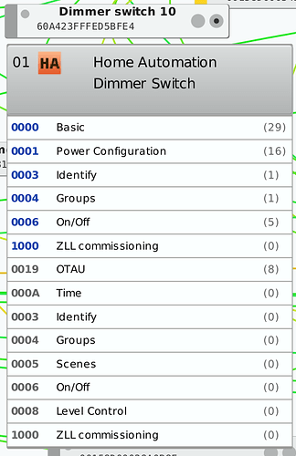

The Destination Settings window only makes sense if you select a cluster on the node that represents the switch. To select a cluster, press the right-most gray button on the node:
That pops up a window with the clusters for the node. Click each one to see if the address mode changes to Broadcast (any of them) for a particular cluster.
