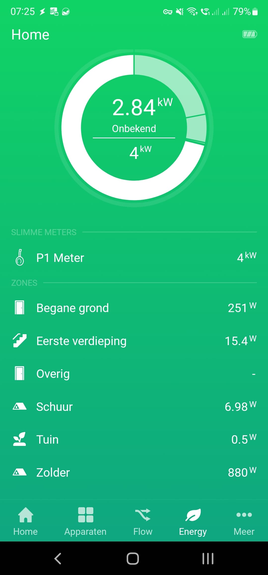

Does anyone know if its possible to get the “unknown power” into a variable or tag?
I have most of my plugs monitored with the exception of the stove and pump, I’d like to calculate /guesstimate the draw of these items but I really don’t want to manually add all the known items together…
While writing this I’m thinking there might be a homeyscript solution for this, any help is appreciated.
The top value is all the values added together for the selected zone, which in the image above is Home, so the whole house.
So, the simple calculation is to subtract the measured power total (on the top) from the smart meter power (on the bottom), 4kW - 2.84kW = 1.16kW.
