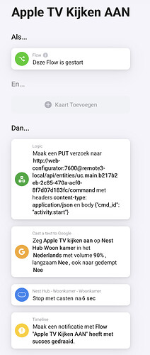

As noted I am former Harmony Elite guy, and with that I could use Homey to start/end activities, without using the remote. Opening up options to start something based on something totally different. This was due to the Harmony Hub app on Homey.
Also Logitech Harmony can be connected through Google Home for voice commands and I have a bunch setup through the house. They basically start through Homey and trigger the specific flow)
Now with Remote 3, yes I can start things on the remote.
And while you can Trigger using the UnfoldedCircle App on Homey BUT that still means it has to be started on the remote’s end.
But what If I want to start something (a activity/remote) without the remote? Well that is where my curl write-up come in.

Voice command example 1 - Triggered through Google
Voice command example 2 - Triggered through Google
Macro example - When housemate arrives and im playing music
Macro example - When it’s time to watch the News around dinner time hahaha :wink:
