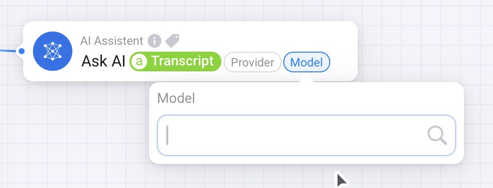

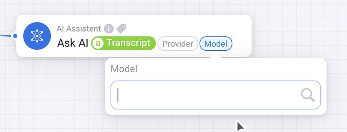

Can you please check flow card setting? regardless what’s setup in app settings it shows gemini as only AI
