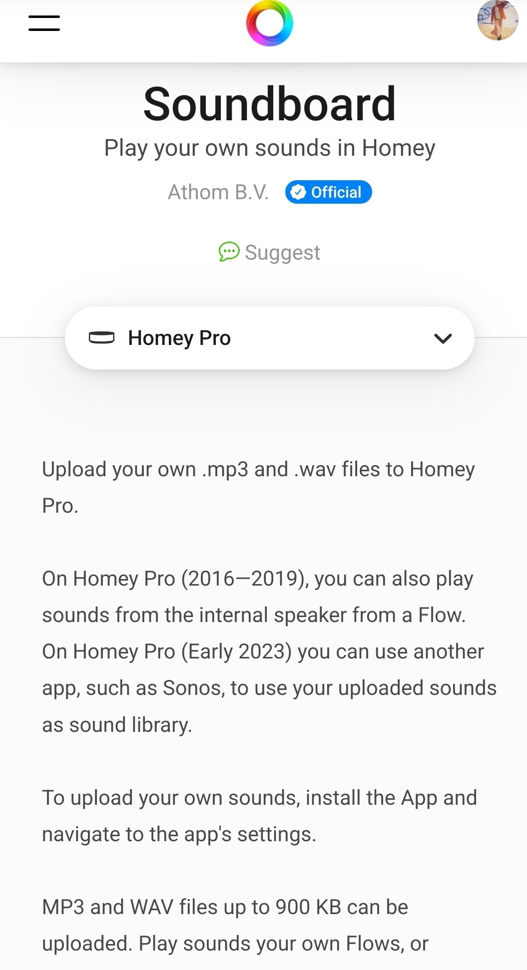

Did you keep the 900kB file size limit in mind?

It’s definitely related to the file size limit:
@HansieNL
I could reproduce, I selected a 450kB mp3 file;
The size filter seems off (maybe 90kB instead of 900)

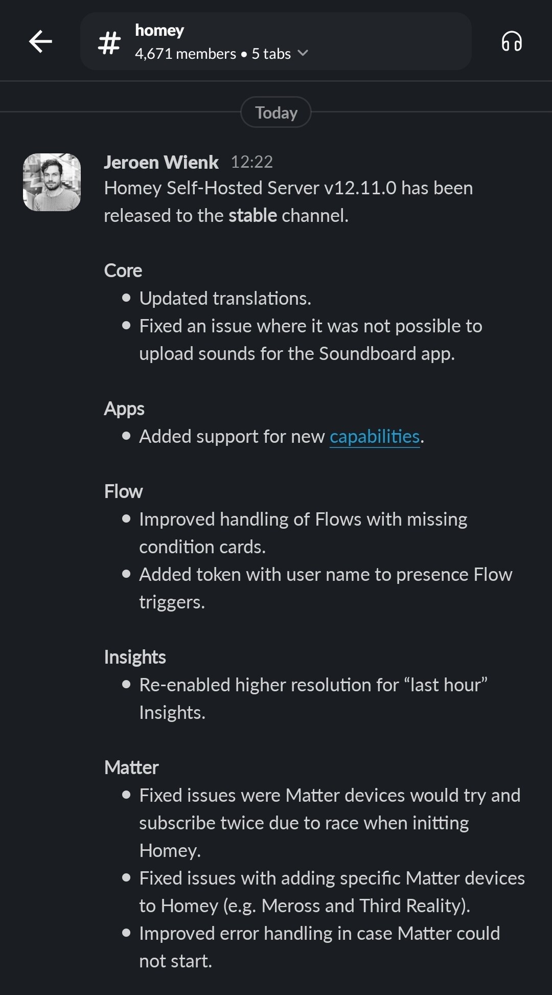

Should be fixed with v12.11.0
