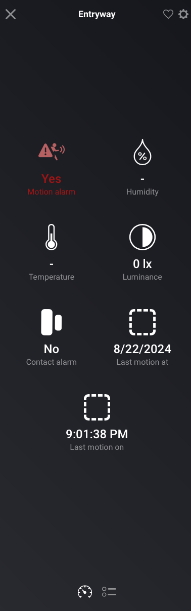

I am brand new to Homey… My first Advanced flow challenge is to create a flow that turns on the entry lights when motion detected there and then off after x minutes. I am using a UniFi Protect Sensor, motion and LUX enabled. The motion alarm has gone off on the sensor, 4 hours ago when I first installed it and it is still flashing “YES Motion Alarm”. There seems to be TWO motion icons, one reports motion with a date and when I hover the mouse over, indicates 4 hrs ago. The other reports Last motion but time. THIS one is realtime and reports immediately when there is motion.
Despite all this, if there IS motion, the lights do not turn on. I tried a flow where “If motion, dim to 100%” Trying in zone active…" as well but no luck. Anyone have experience working with the motion sensor? Any help appreciated.

If the Motion Sensor didn’t cancel the motion detection 4 hours after last motion detection, then there seems to be a hardware problem, a problem with the Ubiquiti UniFi Protect App or some configurations of the MS are not correct. But because I don’t use this MS nor the UUP App, I don’t have any experiences with this and can’t give you some suggestions.
But in my opinion, these are the first things you should check.

Appreciate the feedback. It is definitely not programming. The issue isn’t that I am a novice. It is that the motion alarm NEVER stops… still going 8 hours later. Yes, I get that my initial post here looked bad… I fixed it quickly here on my end.
I put the Hue motion sensor back in the entryway and it uses a “motion alarm” as well but when motion stops the alarm turns off. The UniFi Protect sensor integration with Homey just simply does not work. A pitfall of community or open source I suppose. Always bugs, always something broken.

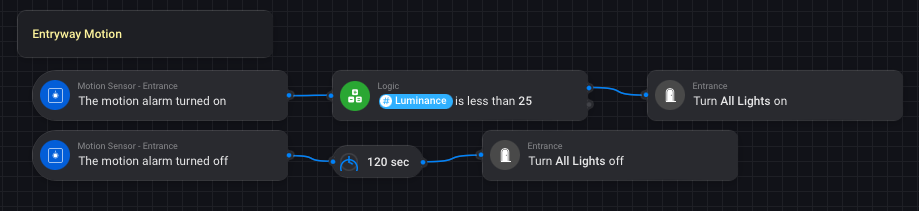

Here is the flow I have now using the Hue motion sensor and it works fine.
In the Advanced Settings there might be a “Time out to reset sensor value” which you can set for example to 1 minute.
Please don’t use the build-in delay card to turn off the lights. Instead of The motion alarm turned off in combination with the build-in delay card, please use the flow card The zone is inactive for 2 minutes → Turn All Lights off.
In this post I tried to explain the reason, why the build-in delay card can lead to an unwanted behavior. It’s just in German, but with a translator I guess it will be understandable. If not, just ask.
