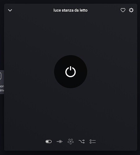

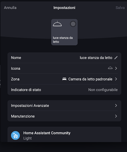

I launched a basic instance of Home Assistant via Docker on a mini PC that manages some of my home network settings. I didn’t configure anything else on that instance except the app for handling Tuya devices locally. Then I used the Home Assistant Community app on Homey to integrate the HA instance with Homey.
After a month of testing (yes, I’m still testing since I’ve only recently started using Homey), nothing has ever crashed neither the app on Homey nor the Docker instance on the mini PC. I’ve never had to reboot anything. I’m not experiencing any latency issues, and the devices behave as if they were directly connected to Homey.
I’m not sure if I just got lucky, or if the specific devices I tested happen to work particularly well, while others might be more problematic.
That said, I wouldn’t recommend buying Tuya devices relying on this method especially if it’s for something important or expensive (as far as Tuya devices can be). But in my case, as I mentioned, this is just an experiment, and I already owned these Tuya devices for a few years, so I figured it was worth a try.
