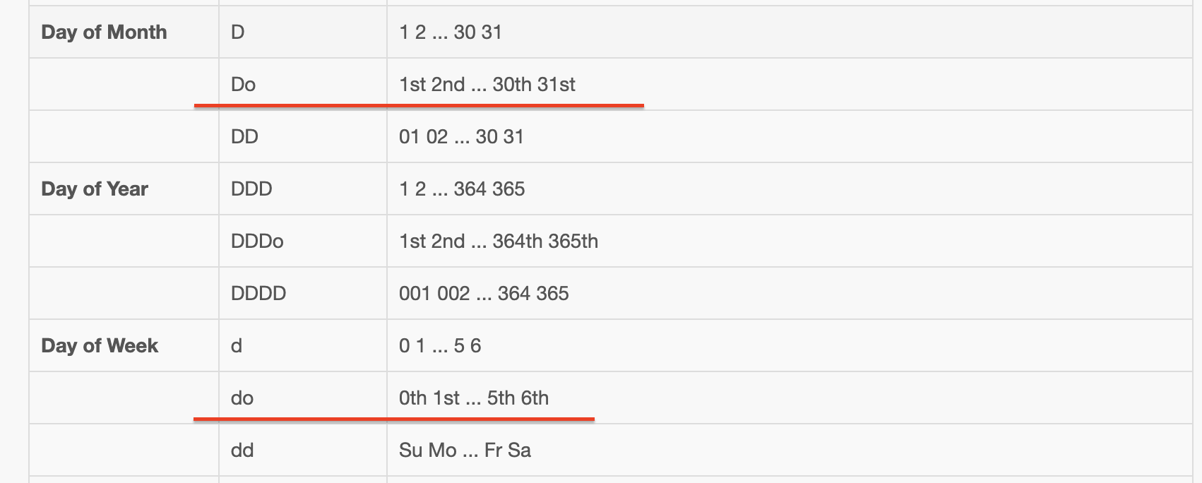

It might sound like you have used the wrong format, maybe switched Do and do ?
@Peter_Kawa How do you get that capital letter on the weekdays I used this designation:
ddd DD-MM
I get small letters.
If I change that small d to big it doesn’t make sense anymore.
Indeed I did … facepalm
ah ok perfect, I did not check github, only the top of the thread.
I’m starting to get the hang of the community, I am still a newborn xD
It depends on your locale.
ah okay and that can certainly not be changed because then hole homey will change?
Correct. The locale is determined by the Homey itself. If your Homey is set to one of the languages my app supports, it will use that locale. If it’s set to another language which my app doesn’t support, it will fallback to english (en)

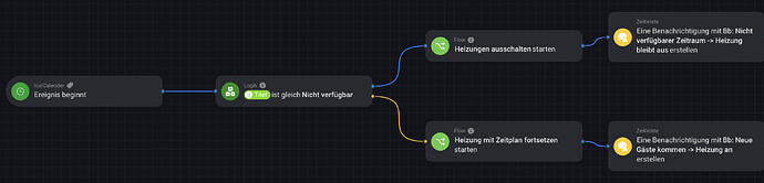

Here are my full flows.
Event begins
Event ends
I use the “Title” to differentiate between periods. If “Nicht verfügbar” (Not available) is the title, the heating should turn off as well. As the start and end time can be the same, I place the “delay” in the event end flow to make sure that the “event ends” flow is executed after the “event starts” flow, but it still returns the title of the previous event instead of the actual running event. Whereas “Event starts”, which runs before, gives me the correct title of the newly starting event.

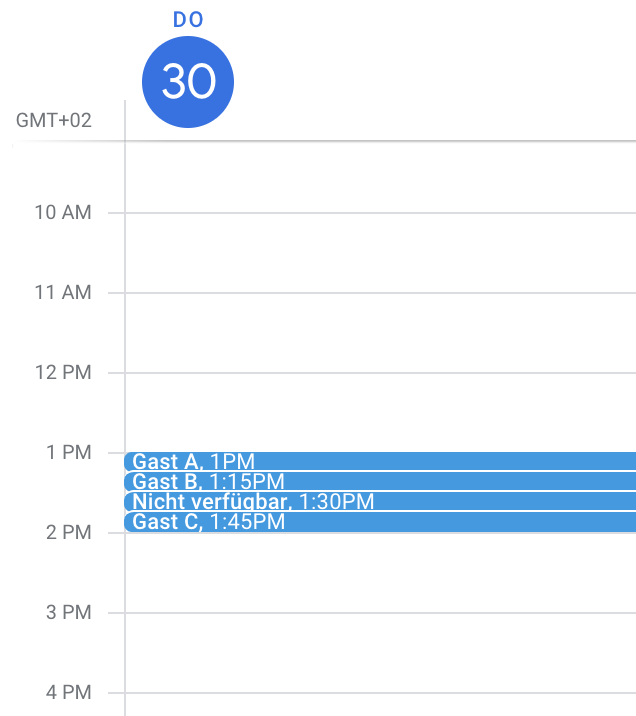

My event test set up in Google calender looks like this:

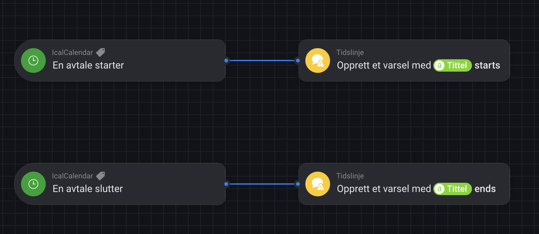

Just tried here and everything works as expected.
Skjermbilde 2023-03-30 kl. 19.03.15
Okay, I’ll check it again but your results are mixed up as well. “Event b starts” before “Event a ends”. Is there any possibility to bring this in the right order?
For triggering a heating it’s not useful if it’s turned one with “Event b starts” and directly turned off again with “Event a ends” after.
If you look at the timestamps, they are logged at the exact same time, meaning they are equal and Homey will anyway be the one who determines which trigger card will be triggered in which order.
You see this on Event b ends and Event c starts
