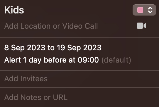

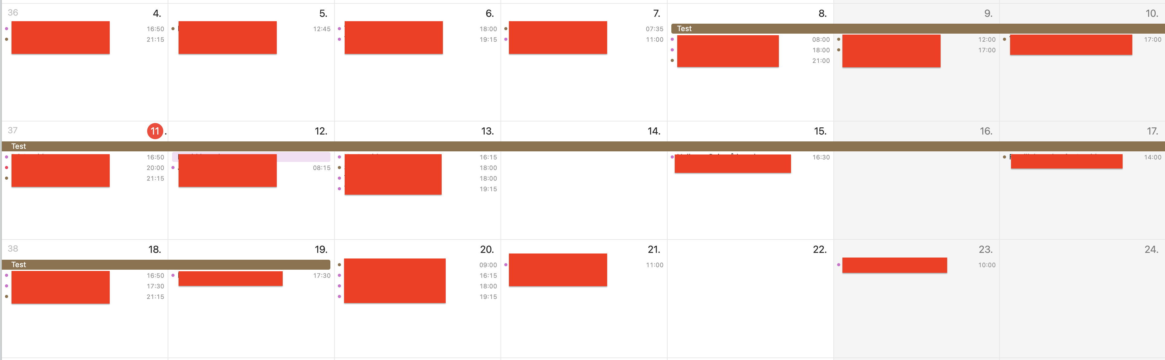

I have a question regarding ongoing events that started in the past. I have an ongoing event that repeats and are several days long. I’m using this “and” statement: “Event containing bla in calendar bla is ongoing”. If the ongoing event start this day (full day event), the “and” statement works. From the next day on it doesn’t work anymore. I see this event not in “Bla is ongoing”, I see just the future events, but not the current one. In the settings I see this comment: Events with start date inside given time frame will be synced in". Not sure what I do wrong
Can you please provide an example of an ongoing recurring event you have in your calendar? The event you are referring to, is it actually ongoing for several days or is the start/stop timestamps inside same day but is repeated several days?
I created a new ongoing recurring event in my own calendar to see if this works as it should. This event started yesterday and is ongoing until tomorrow evening, and will repeat itself every sunday.

And my calendar
And the details of the calendar entry
Screenshot 2023-09-11 at 20.21.50
I created an event just like that in my own calendar, and it works as it should at my end.

Thanks, yes I know about the start button, but thank you :slight_smile: . When I run this flow the variable doesn’t set correctly, so it seems like it doesn’t find the correct/current event in the calender.
And the current ongoing event is not visible. Just the future ones
Well, since none of the events you are showing in the list has started yet, the variable should be set to No :wink:
Hehe. Exactly that is the problem. Why does the current event not show up?
Since the event isn’t showing up in the list, its not imported!
