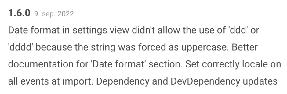

I just released v1.6.0. This should make it work better. @j_wak , could you install this version and let me know how it turns out?
Success! Thank you!

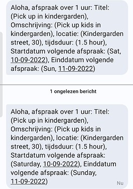

Screenshot from 2022-09-10 23-47-42
Formats used:
ddd, Do MMMM YYYY
ddd, DD-MM-YYYY
