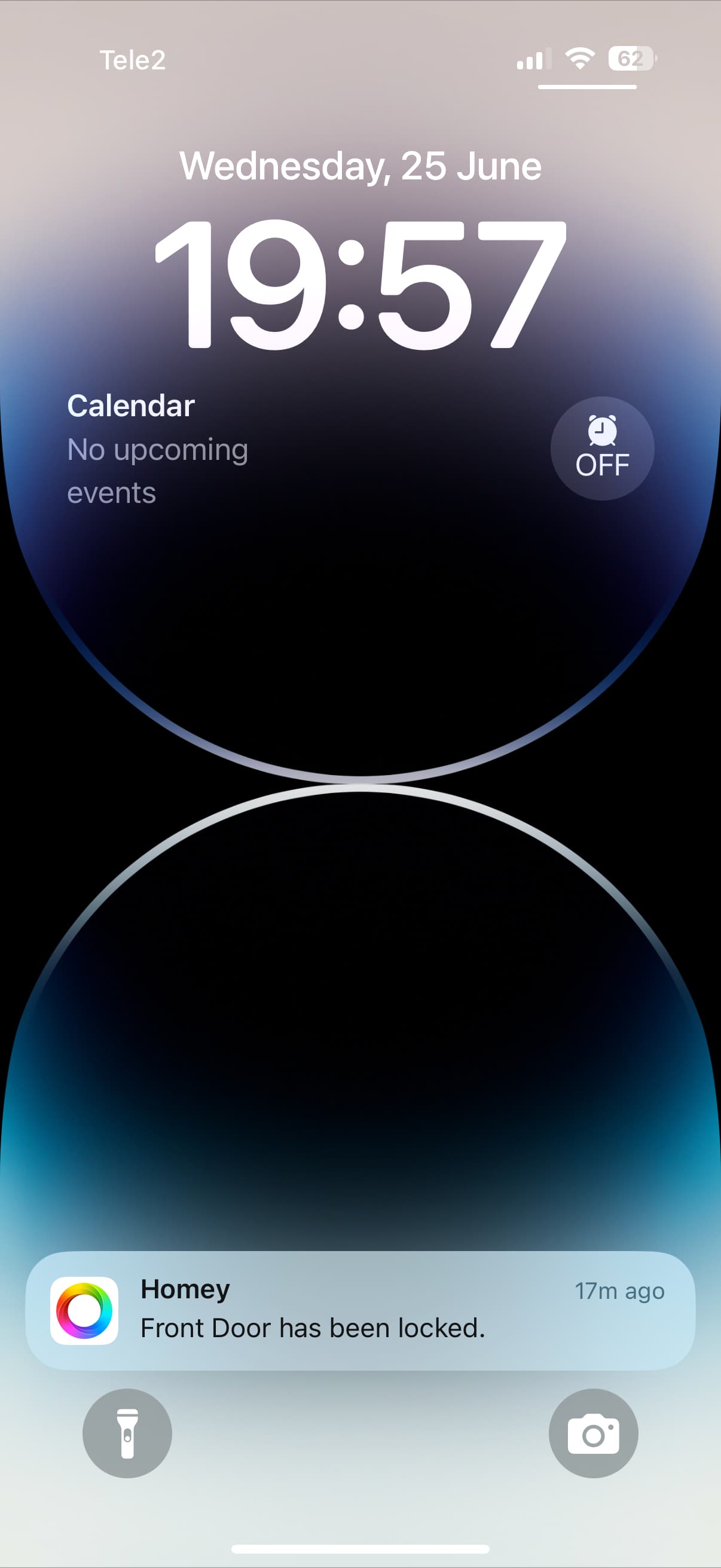

Everytime my front door opens I get this notification. Can I turn it off if I am at home? This is not from a flow.

I have a Yale Doorman L3S and an IKEA Parasol door sensor I added recently. I don’t think any of these are causing the notification, but rather the recent update I got related to the critical notifications. I could be wrong.
Yes, this is the solution I had before, but I was afraid of not receiving other notifications that I do want to get.

Correct. I don’t want to receive push notification for security category when I am at home. I still want to receive them when I am away. I think it is easier to just turn off push notification for security and create flows to trigger them when I am not at home.
