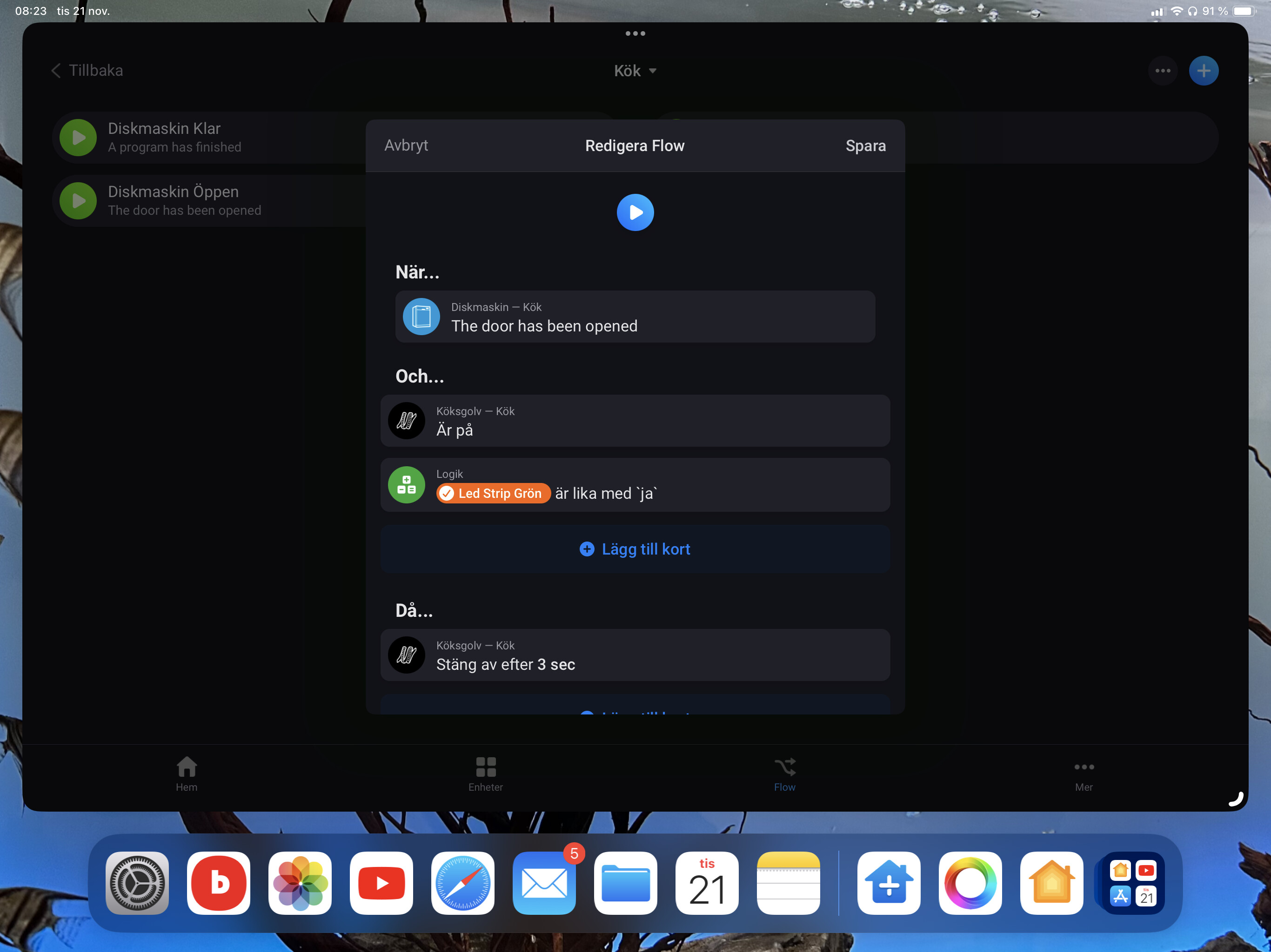

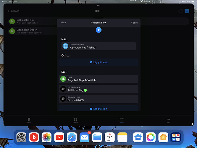

That’s an idea, lucky for me my Siemens dishwasher has an app in homey. So I know when it turns on/off, start/finish, opens/close. So I don’t need to guess when it’s finished. I tried to make a variable yes/no. Added the variable when dish is running- then it’s NO, when it’s finished it’s YES. But I can’t add that variable in the “AND” state in the last flow. When door is opened, and variable is yes, then turn off. This would be the natural way to go. But the AND described is not possible
Here logic cards come in handy, use those for the AND part.
Thanks. I think I got it right now. Added a variable in a then section in one flow. In the next one I added the same variable in the AND section. So if that is not true it will not execute the action.

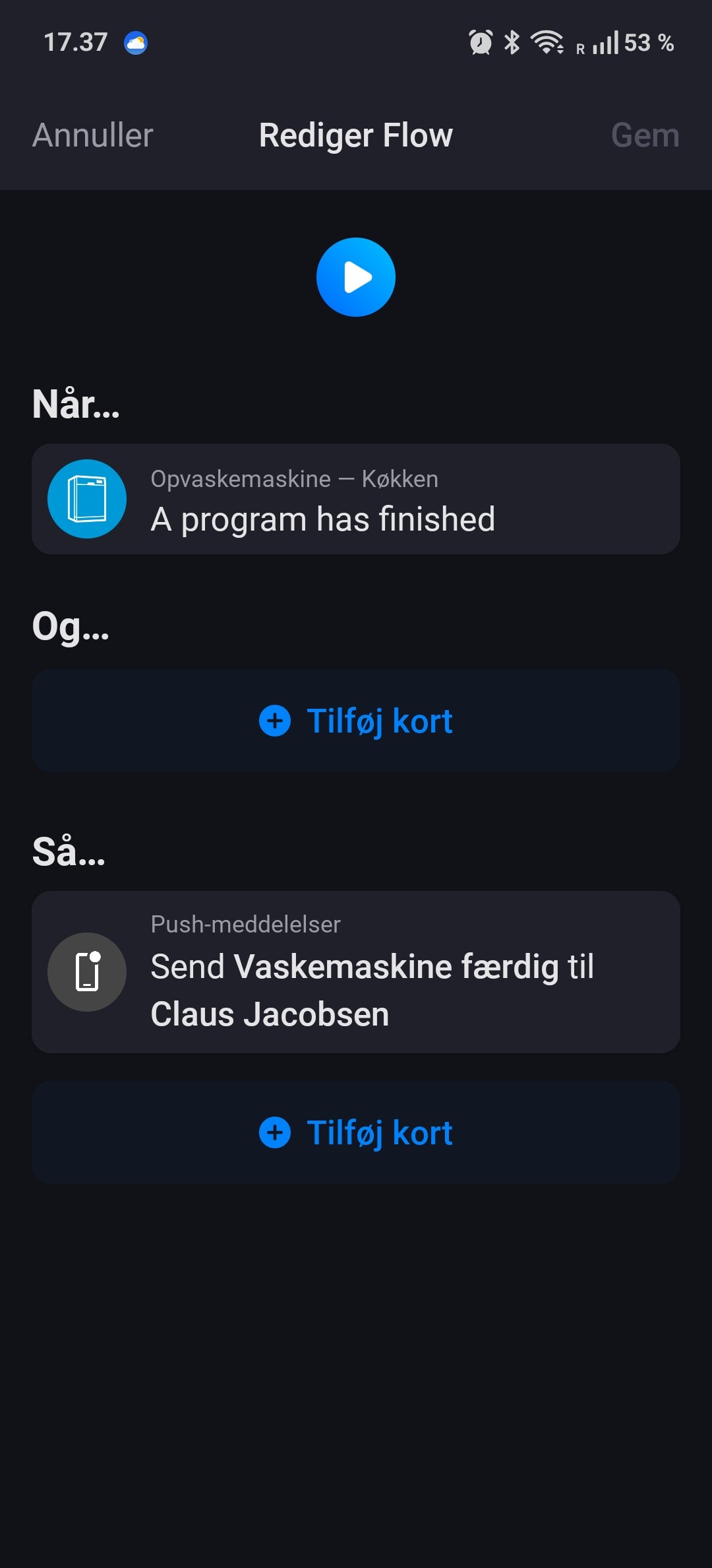

How do you get this flow to work?.
I have the exact same flow, but just an notification in the then, but it is not working when the program has finished :thinking:
