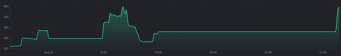

See the flat line that keeps coming back.

This can be checked if the graph for the virtual device has those flat lines too.

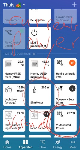

My “Toon” (Slimmeter) and the virtual power measure device:
Insights:
