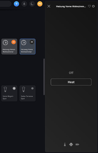

These are Bosch TRV (Bosch Thermostat II [+M] - Matter over Thread), but my Eve are exactly the same. In this screenshot one is heating and the other not, but all these TRV have OFF/HEAT settings. Setting them to off does not change the tile visually. The tiles should fade as the bulbs in the screenshot.

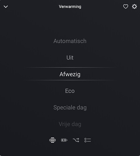

Just out of curiousity: I red the manual and could not find on/off. Is it on the TRV itself? My EvoHome controller has more modes, including off. So I can imagine your on/off has been seen as “mode”, as discussed earlier in this thread (in the original location). I wonder how Matter would represent this.
When I switch to off, the set temperature is set and shown as 15 degrees.

Yes — it’s a mode on the thermostat itself.
Matter defines a set of standard operating modes for thermostats. The core ones are typically OFF and HEAT, and depending on the device there may also be COOL or other modes. What Matter does is strictly define how these modes are represented in the data model to ensure interoperability — but it doesn’t force a device to expose all possible modes.
That’s why my Bosch and Eve TRVs only expose OFF and HEAT, which makes sense for radiator valves.
