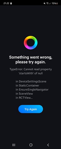

But when I want to edit the thermostat device using the mobile app , this screen below pops up.
After hitting “Try again”, I can’t do anything, a fixed reload sign appears.
I have to force close the Homey app to be able to use it again
A Homey reboot didn’t make a difference
