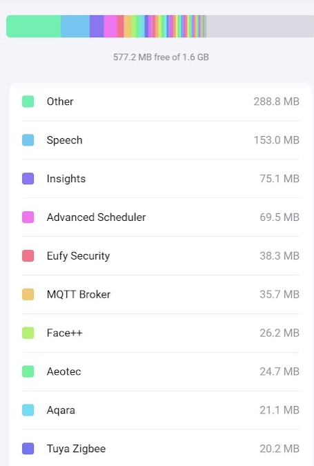

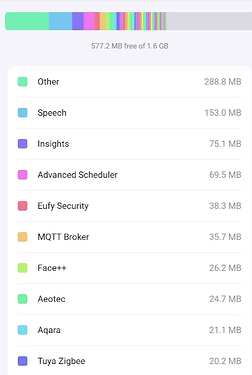

Btw, out of interest :
before firmware reflash on HP Pro 2019
and after firmware reflash on HP Pro 2019…
In my opinion you can’t compare a device under memory pressure and another without memory pressure.
Beside that also the architecture in Homey Pro (Early 2023) is completely different as it uses containerization where the old Homey used other isolation mechanisms.
