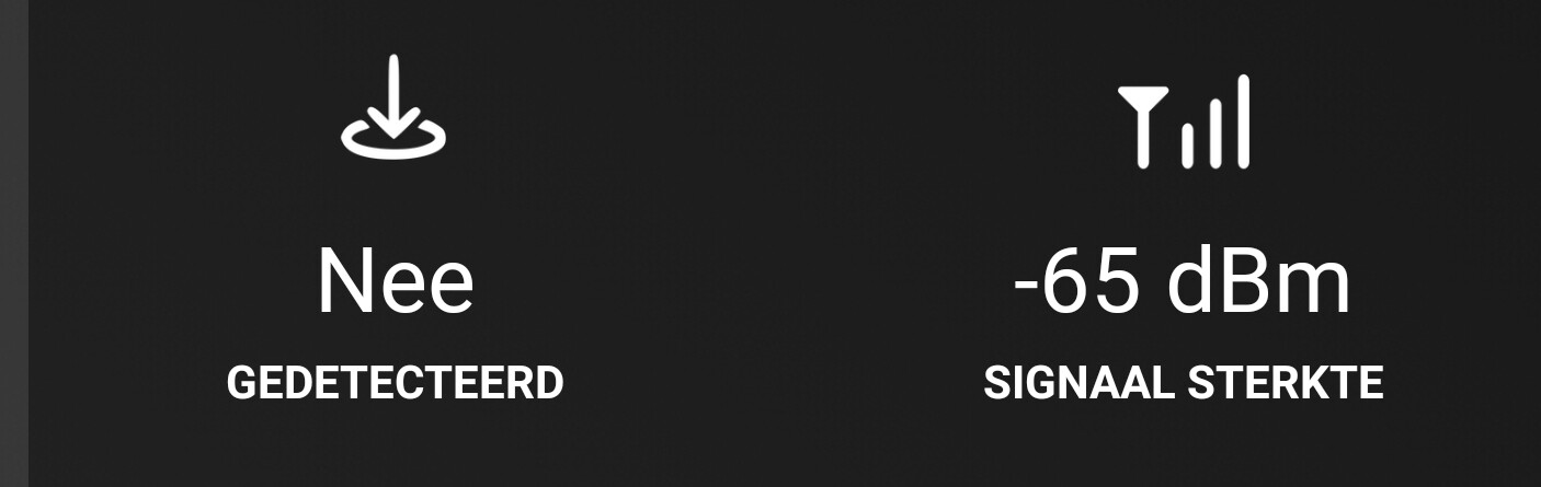

Here you can view the signal strength of your BLE devices Homey Developer Tools
And keep in mind WiFi and zigbee operate in the same frequency range
Thanks for the suggestions. Range should not be an issue, Homey is within 2m of the curtains.
When looking at the dev tools, which value represents the signal strength? RSSI?

It might help if they’d added the unit at that dev page, dBm :grin:

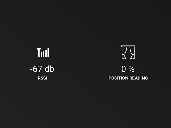

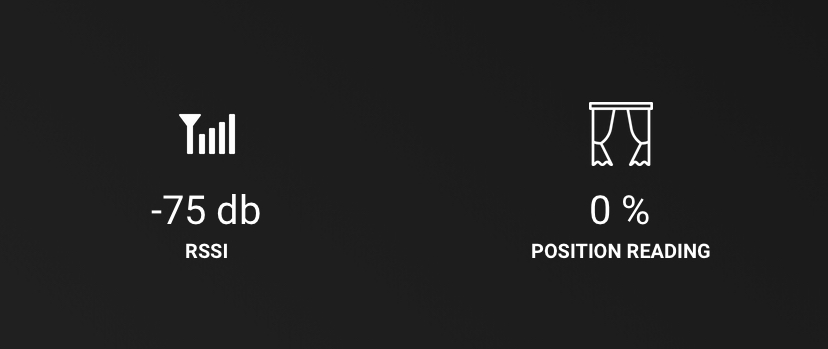

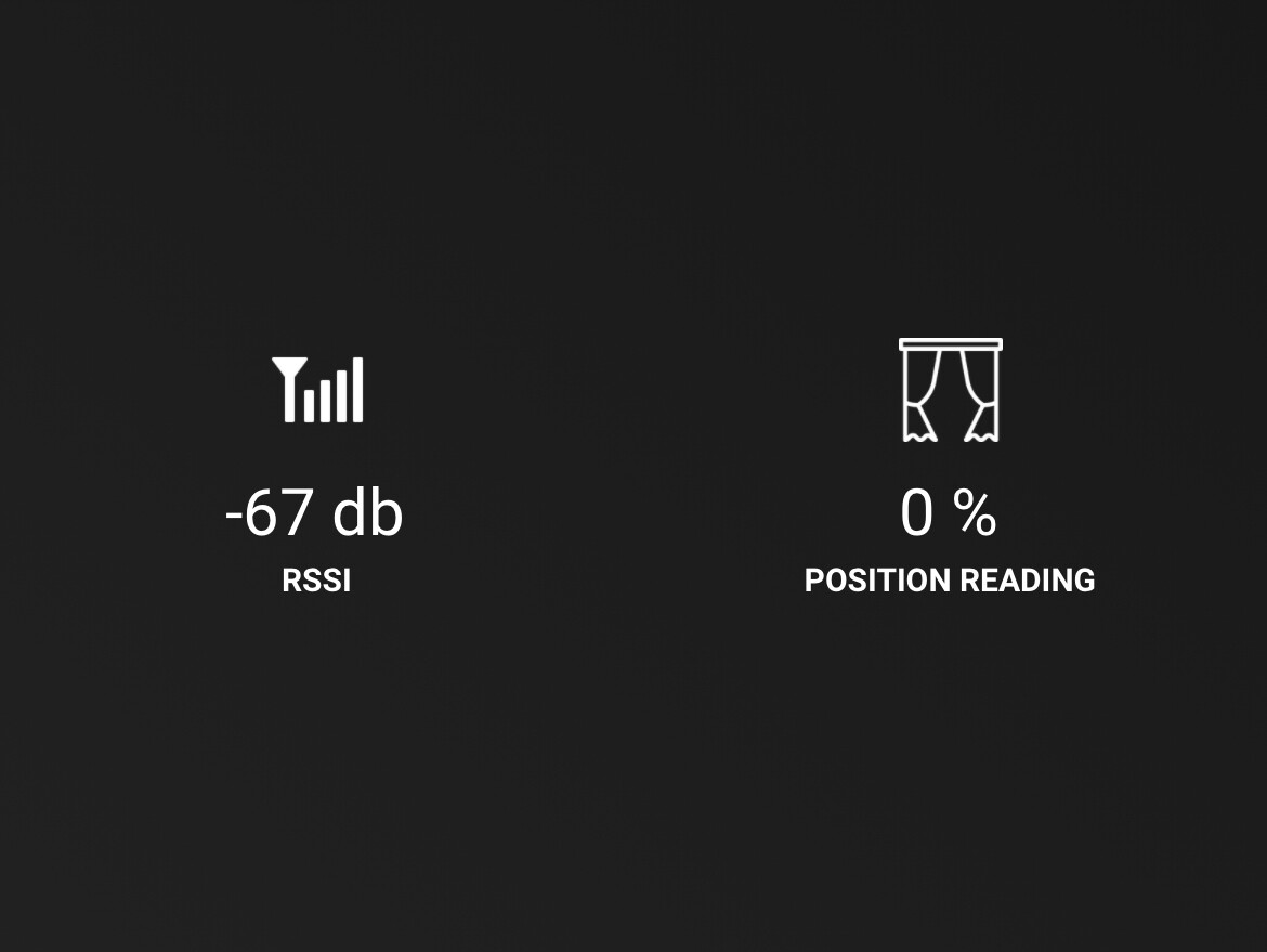

In the device settings, it’s shown (at the Beacon app it is)
Switchbot has the rssi information on device settings too.
And I’m using Switchbot a couple of weeks now, not recognizing your issues, fortunately.
This is in my settings:
