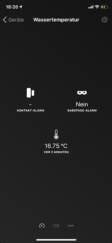

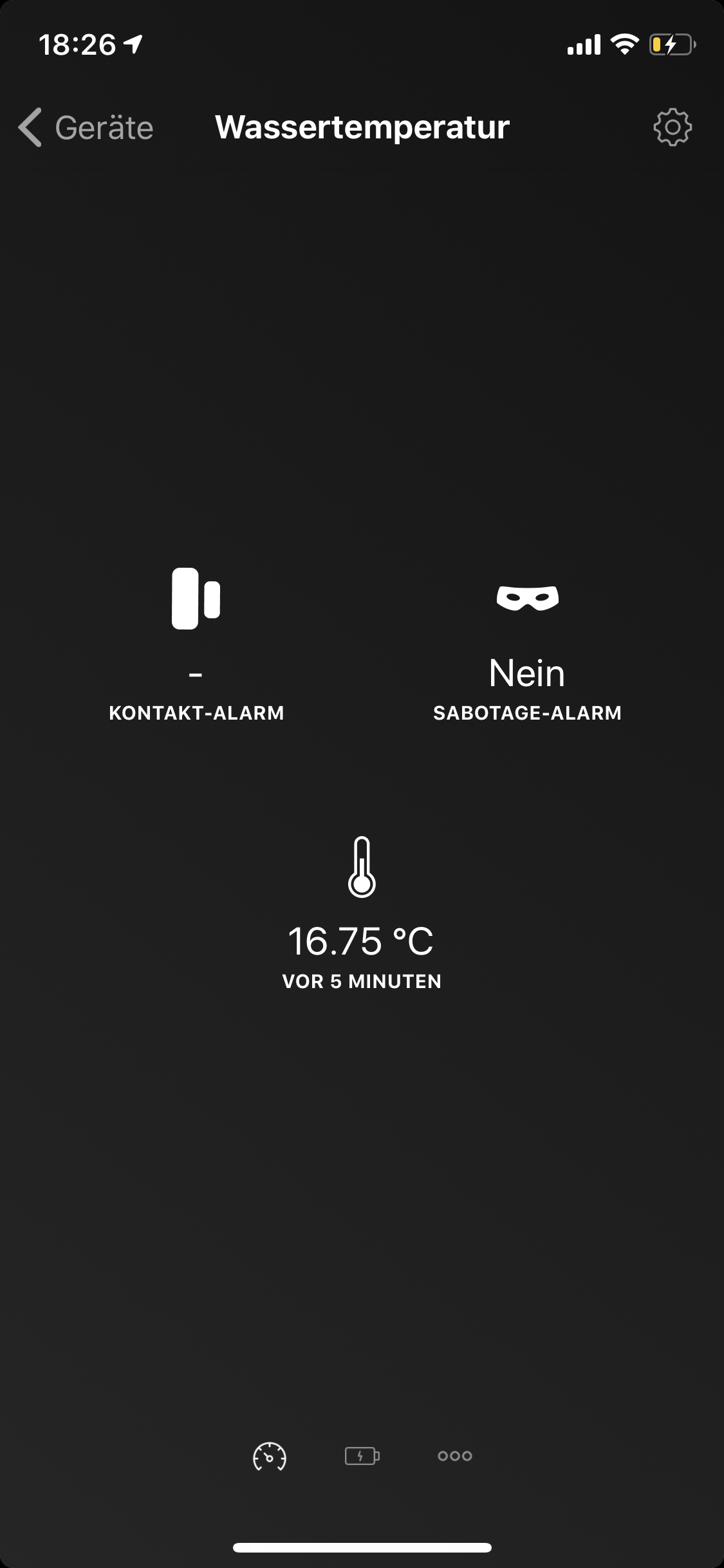

So I’m connected to Homey and downloaded the code from Github. What next? Can I install it via CLI without deinstalling the original Fibaro App? I just want to avoid loosing all my Fibaro Devices.
Yes you can, just don’t uninstall the app, if you want to switch back to the app store version you can just install that over the CLI version again without issues, all will leave your devices there.
YOU ARE AWESOME!!! It worked. You made my day. Thank you soooo much. You don’t know how happy I am right now.
