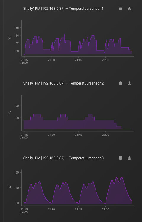

The shelly 1 with temperature add-on will measure 3 sensors. The sensors are waterproof.
A lot cheaper (€37 including 3 DS18B20 sensors) than the fibaro
The shelly app does not have a lot of functionality.
But with homey it works like a charm…
