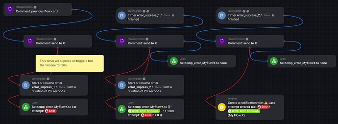

So I “translated” your case to:
  • save the first 1 or 2 errors, in case the second or third card errors as well;
  • only when the third card errors, send all 3 errors to timeline;
  • when the third card doesn’t error, wipe the first 2 saved errors;
  • when the second card doesn’t error, wipe the first saved error.
I used a variable to temporary store the 1st and 2nd error message:
I hope it’s usable, or at least give some inspiration !
Wow, very impressive!
I will definitely use this, but for more singular things in flows, very cool indeed!
