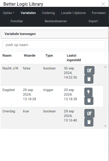

For the Better Logic I’ve setup the following values, perhaps the “dagdeel” in this one is not correct?
Also it is wiered that the “lichtbehoefte” at the moment is more then 50, see the need should be “no”. But in the flow I can see it triggers on “yes”…??
Unfortunately, you haven’t explained what is not working properly.
And like @sschot, we know/understand the difference of the dagdeel variable.
What means Nacht J/N and what means Overdag?
When Nacht J/N is = N, then it’s Overdag, isn’t it?
You also need to build flows to change boolean Better Logic variables to switch between “false” and “true”.
I don’t use the BL App, but what means variable type “trigger” and when will this variable be triggerd?

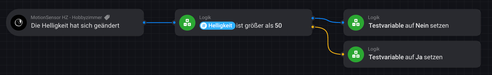

However here are first suggestions to simplify the first flow:

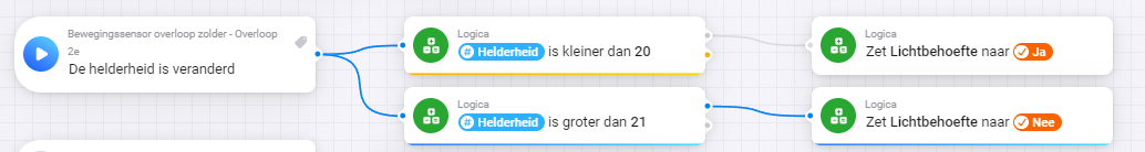

If luminance changed, and luminance IS > 50 (blue line) then set Lichtbehoefte to No
If luminance changed, and luminance is NOT > 50 (orange line) then set Lichtbehoefte to Yes

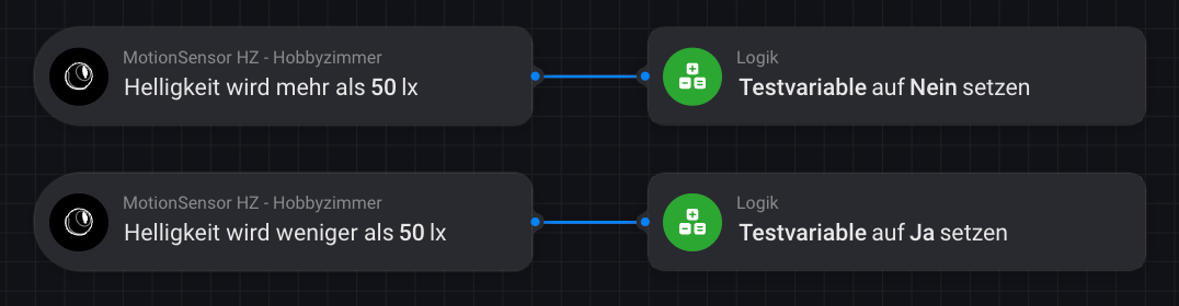

However, the following two flows are better and more resource-efficient because they are not triggered as often as the above flow:
If luminance becomes > 50, then set Lichtbehoefte to No
If luminance becomes < 50, then set Lichtbehoefte to Yes

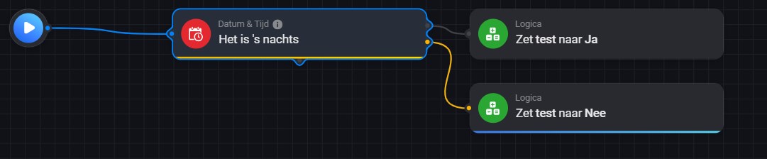

2024-09-30_14h32_33
Maybe this basic chart is more easy to use instead of your build system
Please run/test the first flow also, that the variable “lichtbehoefte” will be set to the right result.
first flow is working ok. Now it is 23Lx and when I changed the value to 20 and 21 it shows the right trigger:

The flow you described to make it more efficient is not working, as it only triggers and works when the variable has hit the number mentioned
So first step is ok.
What happend when you now do run the second step?
And how do change the variables you have made in the BL app? That is for me right now still unclear. When you not “set” the value, there will never be a change of action
Of course does the flow work, believe me. And of course the variable should only be changed if the value goes above or below 50 lx.

to answer the question to Steven: I did run the second flow and it doesn’t look correctly to the “lichtbehoefte”. It now always answers with ‘No’. Very strange.

I did run the first flow as well and then the second, does not worked.
When you check the first flow, do you see it is setting the lichtbehoefte to yes or to no, depending on the available light?
You can check your variable
When this value is changing, it should also change the flow. So please check if you are able to see the var change from value.

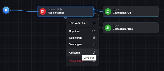

For quick try and error, you can just change the card to the opposite, with the function “omkeren”
2024-09-30_18h11_14

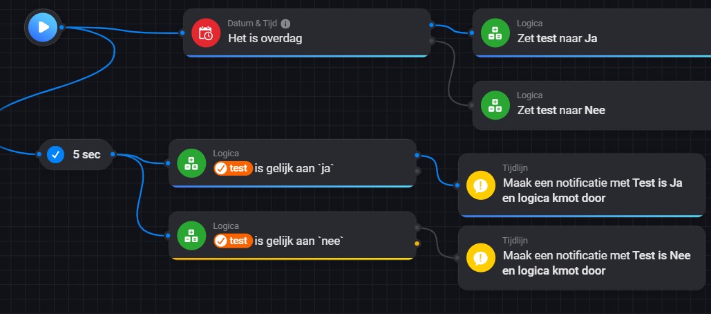

And with yes and no I am not sure, if this text, value or number. Perhaps that is making some additional trouble. But test and check to be sure the VAR is doing exactly what you want.
2024-09-30_18h17_24
2024-09-30_18h17_47
created var test
set to yes manual
run flow
stay yes
change flow
change to no
2024-09-30_18h18_18
Working
and working either
