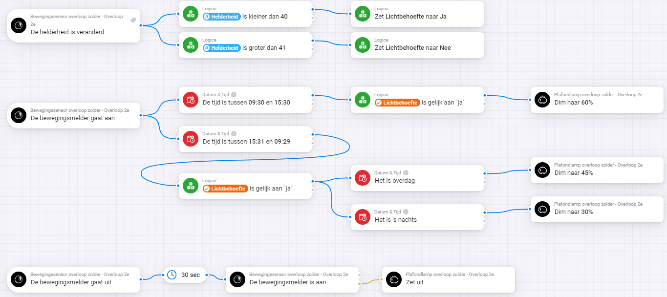

Hi all,
thank you for the support and tips&trics! It is working now! :slight_smile:
Please find here the final flow:
Thank you!
Nice and well done. Step by step to the result you prefer, together with the community!
IMHO this will do the same:
