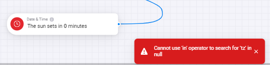

Hi. The cards “The sun rises in x minutes” and “The sun sets in x minutes” creates a weird fault code when I try to save the flow.
Immediatly after removing the sunset/sunrise card, the flow is possible to save without errors.
Any ideas or suggestions for me?

What you could try is the following, it resets the time and timezone settings:
  1. go to Settings / Location
  2. move the map, to have the pointer somewhere in another timezone. Location is saved automatically
  3. after a minute or so, move the card again, and put the pointer at Homey’s current location
Maybe try a different value from 0.

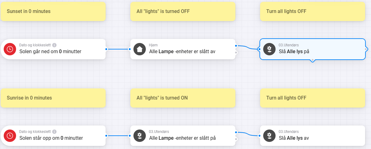

Made a flow with the Sunrise and Sunset Cards, no issue with the saving option. There is going on something else with your Homey. I tried on a HP23. I do not know what you have. You should mention it.
Edit: Top right is ment to be “Turn all lights ON”. It is a typo.
I did a qualified guess that you are on a HP23, since my HP19 do not support “0 minutes”
