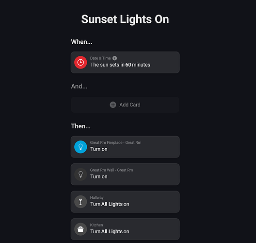

I’m a new user of Homey Pro Early 2023 and I have successfully set up several z-wave devices and flows, but I can’t seem to get one of my flows to work. I want to turn on lights 60 mins before sunset.
My flow card looks like this;
None of my lights turn ON as expected 1hr before sunset, but they do turn on if I manually run the flow card.
What am I missing?

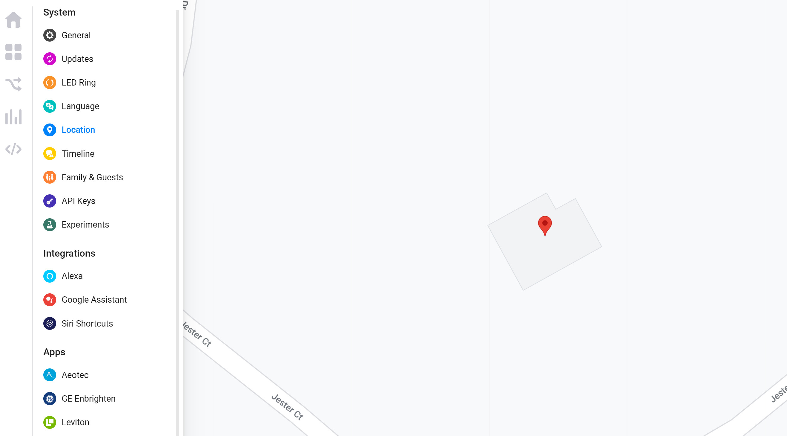

Check your location
Thanks for the quick reply. It shows a map with my correct location, which looks to be automatically detected. I don’t see a way to manually enter a City.

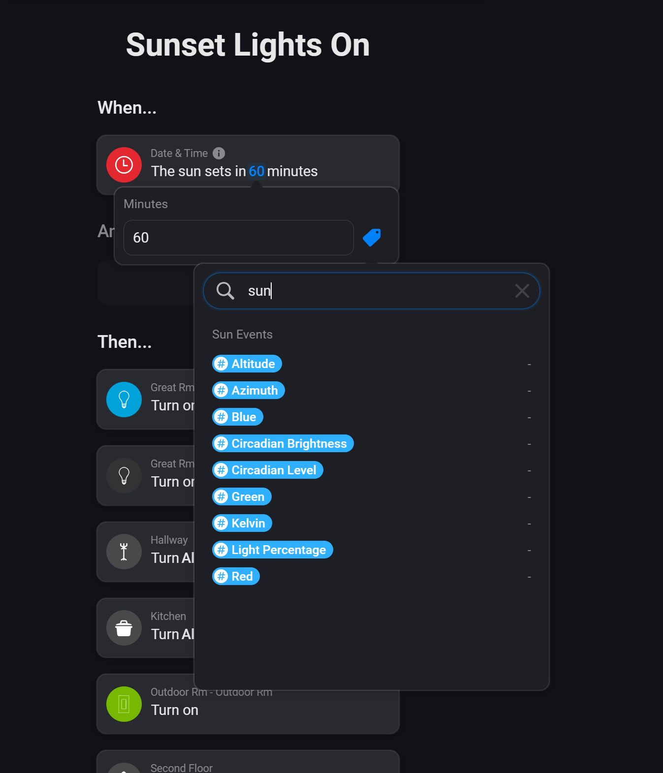

OK, I think I found Tags. When I open the flow and click on 60 there is a symbol at the right that opens a drop down box that appear to be tags. Sunset is not listed.
Various tags from a app called Sun Events is listed but I don’t think I’m using that. I’m trying to use the Homey built in function for sunset.
Is the When card I’m using a standard flow card in Homey? I’m a bit confused now.
If so, why wouldn’t Sunset be part of the tag list?

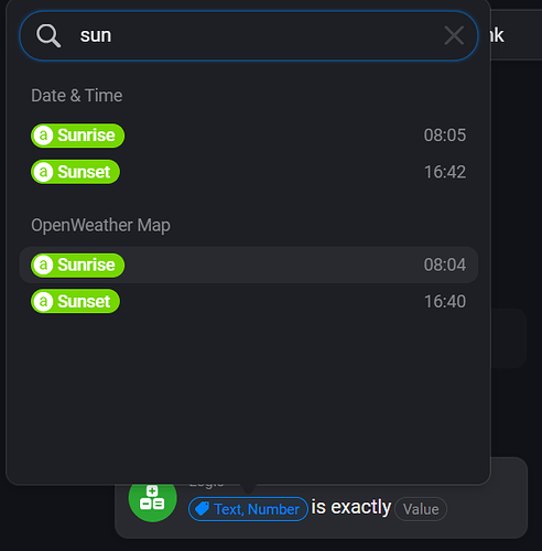

It is a text field, Add a THEN cart, timeline message and search for sun set in your own language.
It is a standard tag, from Date & Time.
Ok, thanks I found them and they’re wrong. They look like a fixed default.
Not sure why? The Developer System Information page shows the correct Date & Time, timezone, and country.
It’s definitely wrong. It will get its value from the internet I suppose. So maybe you have to search in that direction?

The only odd thing I noticed was in my account page it shows that I don’t have any addresses yet
BUT the map shows correctly in the Homey App;
If I move the map around to a different house and return it shows the other house so it seems to “save”, but I don’t see an actual save button. Entering my address manually moves the map to the address.

When I request this tag from Homey Cloud, using the web app, I get the same results, see picture. Could it be you are working with HomeyCloud and Homey bridge and not with Homey Pro? You are working with Homey web app?
These seem to sample values, RMB? Odd…
