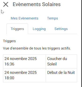

Hi Martin et al, I have a similar issue I think. I am using three Sun Events triggers and everything works fine for two only. I have an issue with the event “Nadir” which shows in the list of time but will not trigger (in this case @ 23:39 yesterday evening). I have set a sms notification and a log to validate over 2 days but without success. My time here is UTC/GMT -5 hours and additionally only 2 “When Triggers” shows in the trigger list if that helps.
Thx in advance
