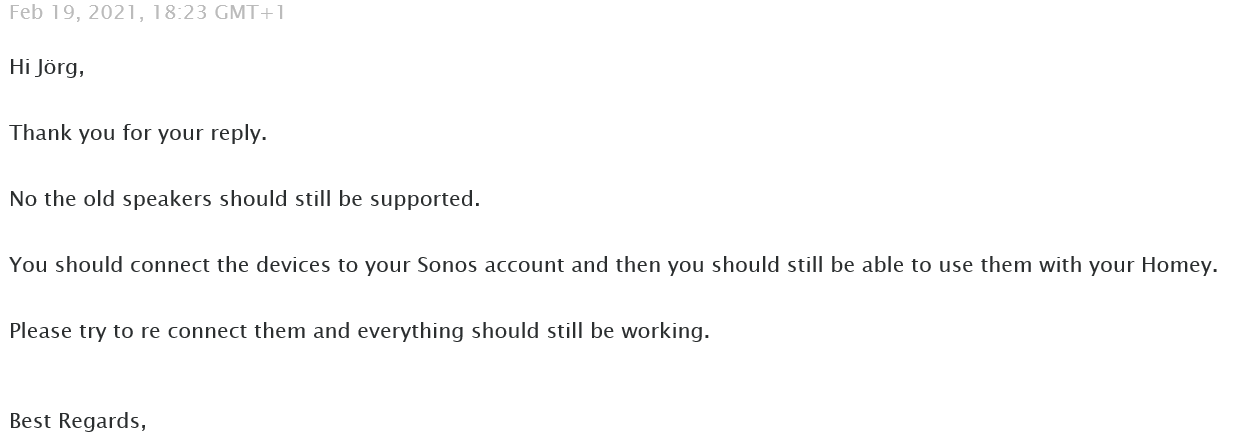

Here is the feddback from Athom support:
I answered them that I will not accept this and they should find a solution for the S1 users. We will see.
After Athom’s feedback I tested it and yes, I was able to pair a deleted S1 device again.
That calms me down but in the app description you see still the warning :wink:

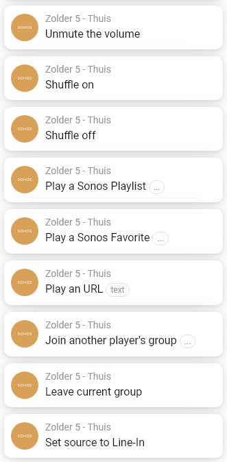

Ok, so i tested the 6.0.7 Hopmey Sonos app.
Please don’t confuse S2 sonos (mobile) app with 6.0.7 Sonos Homey app.
But It is possible to add S1 speakers to the 6.0.7 app. It’s just the functionality like “say” that’s not present on the S1 speakers.
FWIW i deleted the Play 5 gen 1 speaker and re-added it in 6.0.7.
