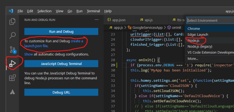

Ah i see 200 chars. Yes i have the TTS flows setup just like the samples. still no sound, just like the play audio clip card of athom. the generated mp3 is checked it is playing from the browser. How can i see the logs and warnings that are emitted in the code?, or even better can i run/debug the code locally using visual studio code? i have tried npm run, that does not start the app.
// Use IntelliSense to learn about possible attributes.
// Hover to view descriptions of existing attributes.
// For more information, visit: https://go.microsoft.com/fwlink/?linkid=830387
“version”: “0.2.0”,
“configurations”: [
“type”: “node”,
“request”: “attach”,
“restart”: true,
“name”: “Attach to Homey”,
“address”: “192.168.1.111”, ← change your IP address
“port”: 9222,
“localRoot”: “${workspaceFolder}”,
“remoteRoot”: “/”
Then you can debug.
Or disable/comment the “if (process.env.DEBUG === ‘1’) require(‘inspector’).open(9222, ‘0.0.0.0’, true);” from app.js OnOAuth2Init.

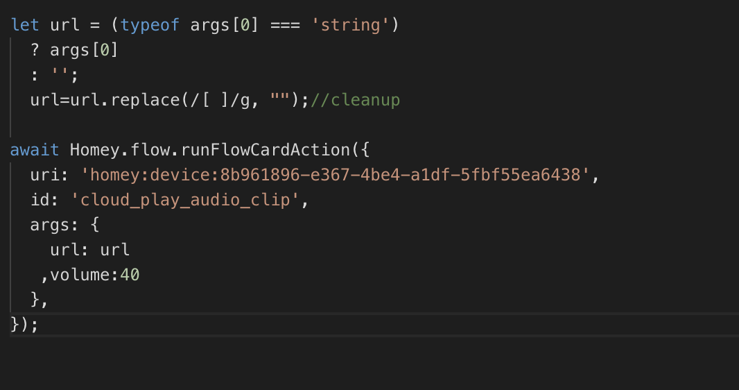

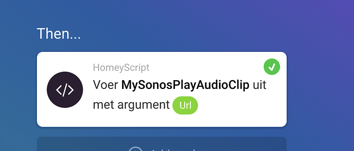

okay, gave up on getting sonos say to work. TTS google services does render a fine mp3. it plays from a browser and it plays if i hardcode the url in sonos play audioclip… but it does not play if i use the [Url] tag, so something is lost during encode/decode of the tag. Maybe a space is added in front of the url? can i maybe call that sonos play audioclip card from homeyscript?
OR can i have tts google service give a hardcoded name for the mp3 it will create so i can hardcode that url in the play audioclip card? Maybe i can rename the mp3 using homeyscript?
, the hardcoded url works for both the beam or the ikea player, the device type is not an issue. the only difference is using the url tag or the hardcoded url.
Okay put the pedal to the metal!. found out how to call the flow card and it now plays!
