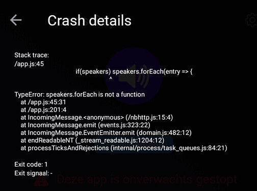

:frowning: when I use the Say card and search for my sonos device the app crashes.
If you enter “http://ip of homey:5005/zones” in a browser what dose it say?
I get the message
{“status”:“error”,“error”:“No system has yet been discovered. Please see TypeError: Cannot read property 'coordinator' of null · Issue #77 · jishi/node-sonos-http-api · GitHub if it doesn’t resolve itself in a few seconds.”}

Yes I got this too. It just solved it self after like 5 minutes of first install. Just wait a bit and try again. Maybe restart the app ones or something. Im running from CLI so during debug it just started running. Seems like a bug in node-sonos since they have an automated response with a ticket.
Funny thing, adding stuff to it now and got it as well.
Dunno sadly. Maybe its crashing and thats why? Don’t know if you can find logs or something. Will try to fix so it don’t crash of the error shown above.

fixed this error in the latest version waiting to be publish (to HCS).
When the speakers are not found yet, the app wil not crash (and burn) anymore.
