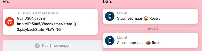

How do I extract this? I’d assume http get flow card, but how to only check for playbackstate?
Yourlocalip:5005/woonkamer/state
And ofcourse in your case use playbackstate
I don’t have that with the ‘and’ column:
What do I have to enter? You have three fields, this one has more.
these are the options on the ‘and’ field:
I use it at the then part and store it into a better Logic variable. After that you can use it for your AND part

If u wanna check if the speaker is playing:
If u wanna check if the speaker is NOT playing:
Invert the card. :wink:
