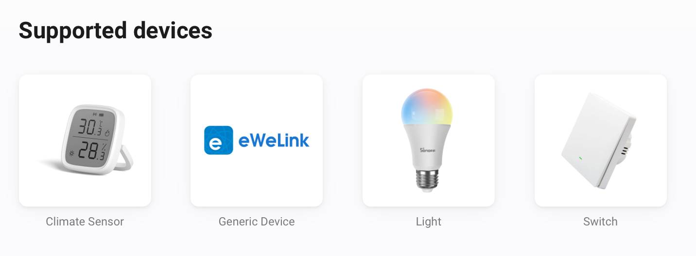

However, as this is a Wi-Fi device, the only possible Homey app that supports Sonoff Wi-Fi devices would be the official eWeLink Homey app. But this app only seems to support single switches, not double switches.
That’s why I suspect that this module was added just as a “generic device.” And generic devices must be addressed via the API, I guess:

But the Homey eWeLink app just supports the following devices:
No 2 channel relay device is listed… ![]()
So if you are able to add the SONOFF DUALR3 Lite, it will probably be added as a Generic Device. And according to the information in the Homey App Store, only the following Flow cards are available for generic devices:

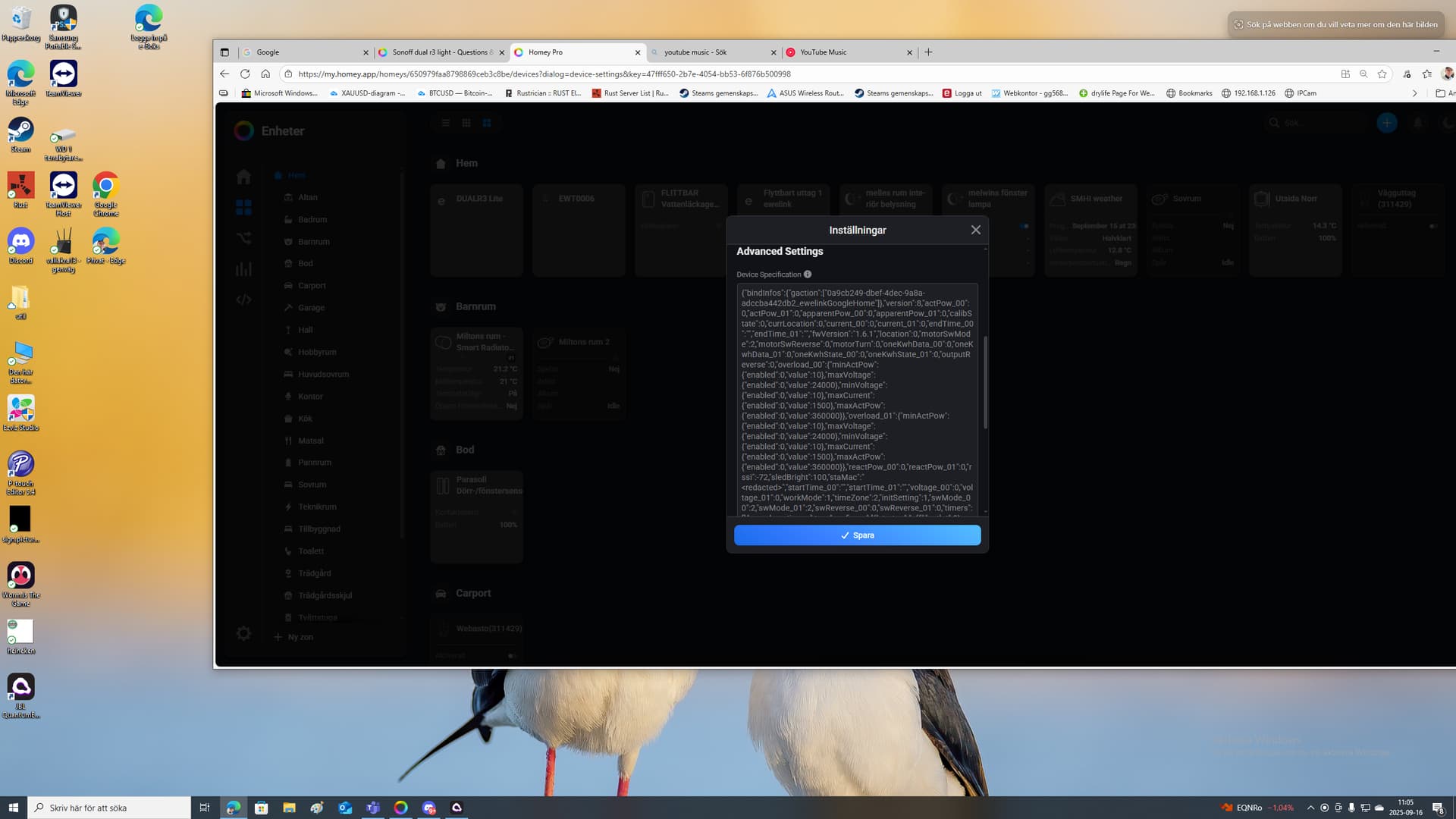

okay, and no 2 channel relay is listed i know, i tryed some of the commands anyway but with no respond from the unit, like the screen dump, i have send a question to developer to see what they can do.
That is what “not supported” implies ![]()
