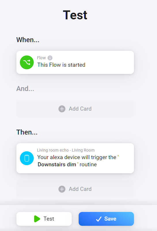

You haven’t added an Alexa device yet. Try adding a device using the method you tried before. Select an Alexa device - I used Echo Plus (Gen2) which revealed my Living room echo which I then added as a device.
You then need to create a simple Alexa routine to execute your scene. I have one called ‘Downstairs dim’ that turns on all the lights in my downstairs hall and sets them to dim using a Tuya scene (I don’t think it matters where the scene comes from).
Test your Alexa routine to make sure it’s working OK.
Then when you create a flow you can create a ‘Then’ card selecting the Alexa device you added and then select the ‘Your Alexa device will trigger the xxx routine’…
Using the web interface, I just clicked ‘Name of the routine’ in the Then card to see a list of available routines including my ‘Downstairs dim’ routine giving me…
Running the flow in Homey executed the ‘Downstairs dim’ routine in Alexa which ran the Tuya scene which turned my lights on!
Doing the same thing in the Homey phone app works in a similar way except, when I tried to choose the routine name, I got a screen showing ‘No results found’ and a search box partially hidden by the ‘Select item’ title. I had to enter part of the routine name to get it to appear so I could select it.
Andy

Finally working!!!
So, for SonOff Dual R3 Wifi Model switch device the solution is found and working!
  1. Create an ambient in Ewe link app for your Sonoff switch device.
  2. Connect Ewe link app to Alexa
  3. Within Alexa app, create a routine based on the ambient created on first step.
  4. Connect Homey pro App to Alexa
  5. Within Homey Pro app using Alexa app you must add your Sonos speaker or echo speaker.
  6. Create a new workflow and on section, THEN you will have available trigger Alexa routine.
thanks, @Andy_Henderson !
