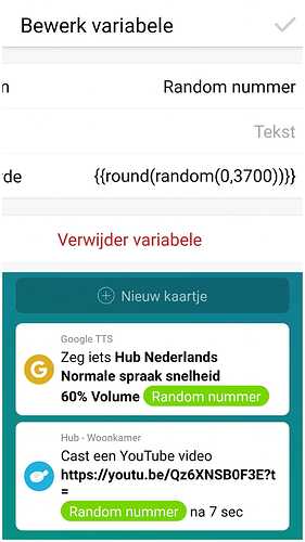

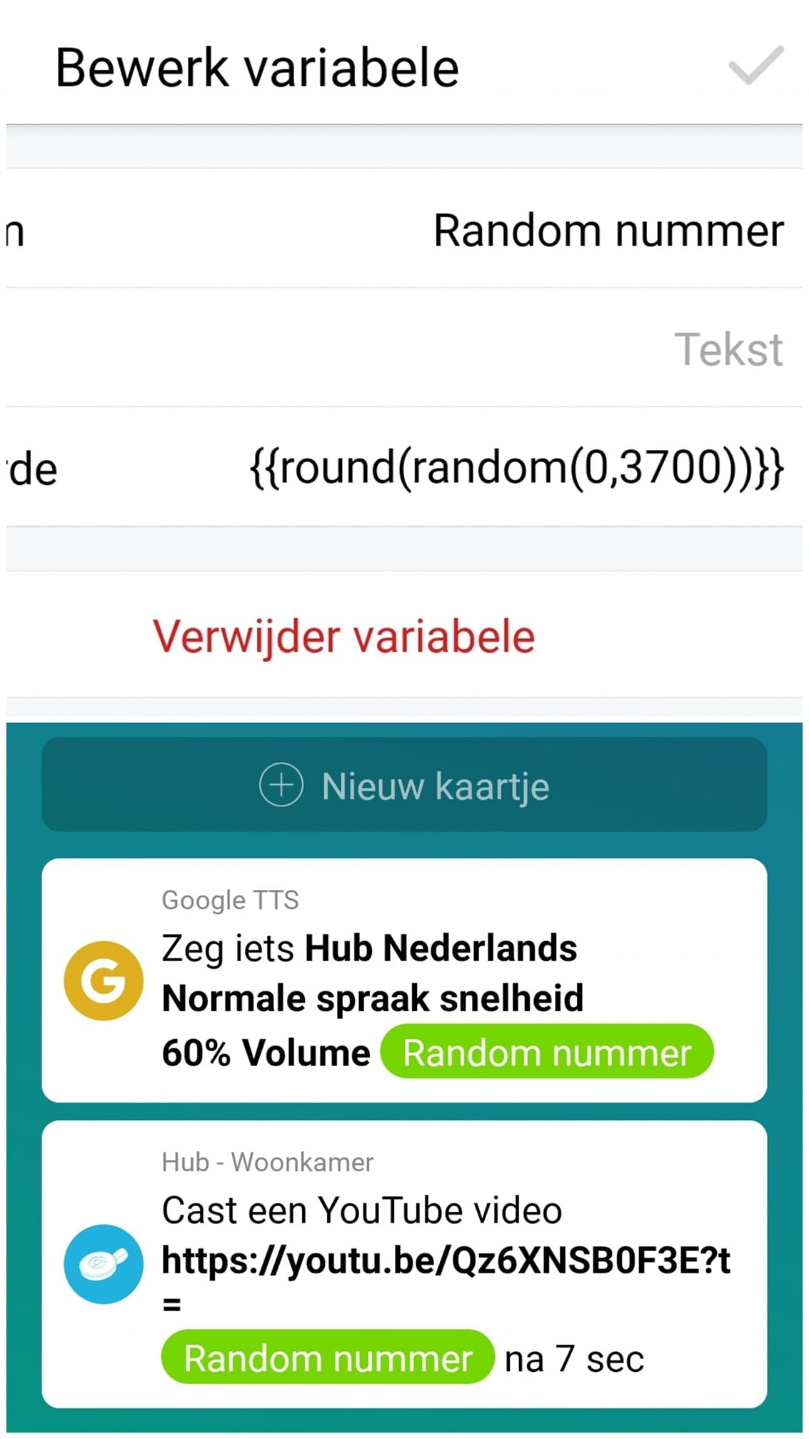

Also tried to use a tag in the url and to let a viarable calculate the random number.
But this also didn’t do the trick.
Google TTS gives a random number, so that parts works, but the video starts at at 0 seconds:
