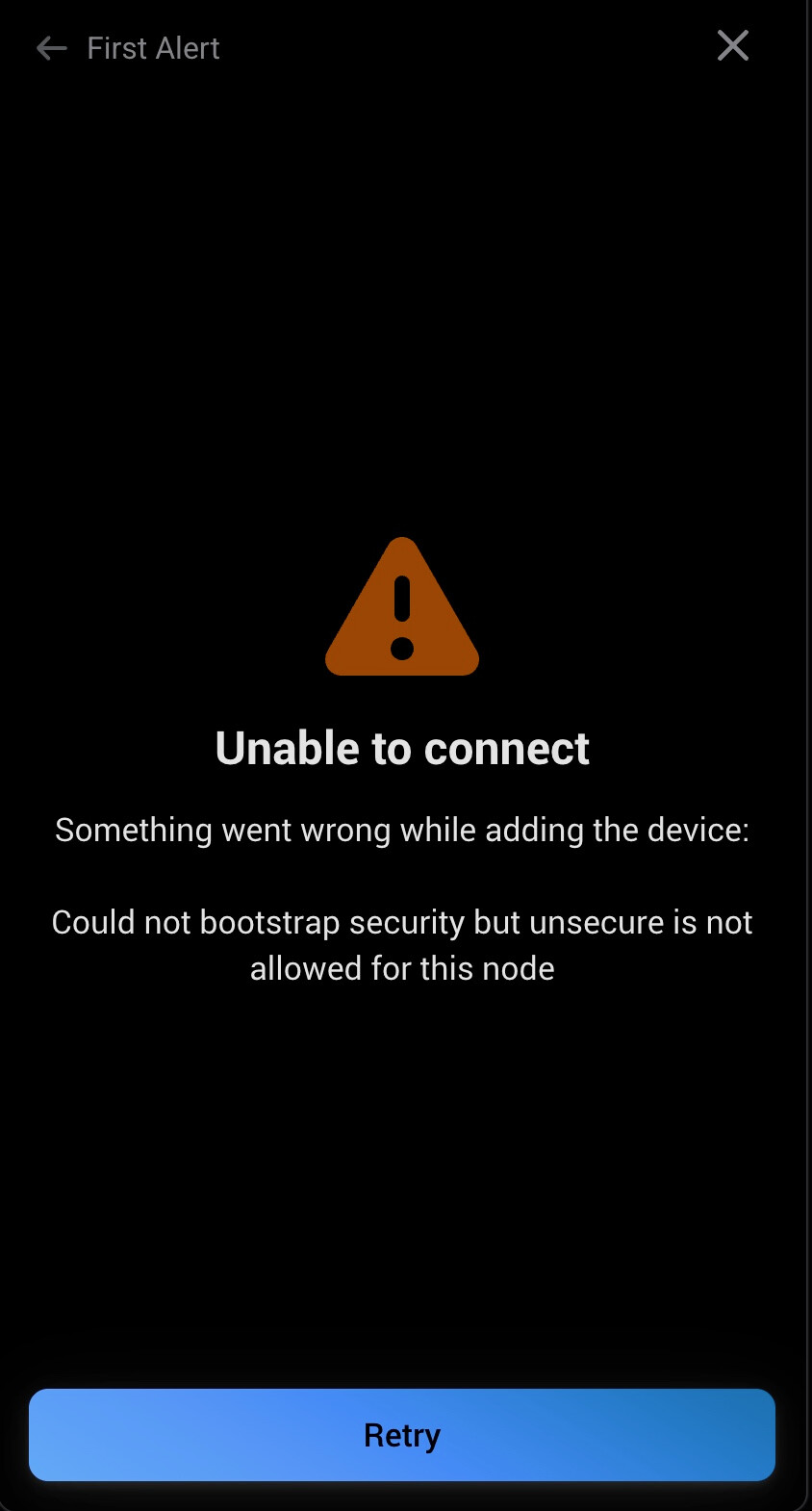

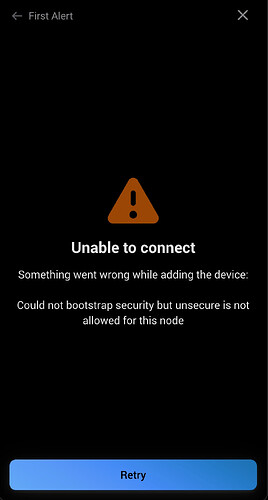

I just sent an email to the author as I cannot get these to pair at all. Just wondering if you ran into any issues? I’m getting following error - thanks!
I’ve got three of these working. I had a forth one from years ago from an old SmartThings system. I think mine was dated something like 2019, or close to that. I was never able to get the older one to connect so I figure it’s to old and not supported. I had some batter leakage happening in mine some I figure it hit its end anyway. There was a newer release which came I thing around June 2024 and these all worked
Two of the smoke alarm connected easy. I remember my finger slipping during the process then it wouldn’t pair the solution for me was to do a fact factory reset on the alarm then it paired
