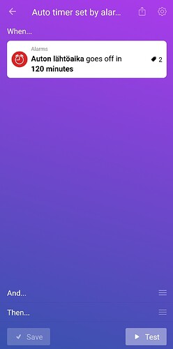

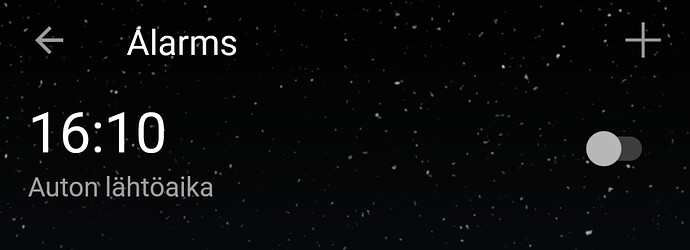

Hi have Alarm like picture 2, and flow like picture 3, but Homey still produce sound when it’s 16:10.
What I do wrong?
Ah, that. Homey only should produce the sound as a default. Should be that as soon as you create a flow to react to the alarm, there no longer is a sound. But maybe the flow should be at the actual time, not before? It probably only works for the “Alarm goes off” trigger.
Just checked and that is the case: The “Goes off” card has a note below saying it replaces the default sound. The “Goes off in … mins” does not. If you do not want anything at the time itself, you can always put in a comment card form the FlowNotities app, or put in a condition that always fails.
