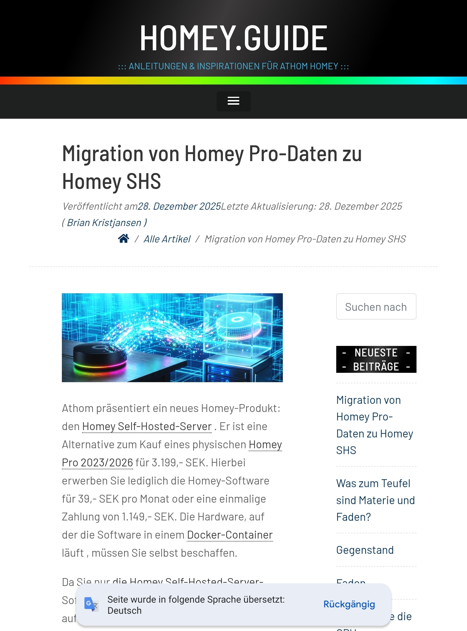

In dänisch, verwendet einen Übersetzer. Hab ich aus dem englischen Forum geklaut.
Adguard blocked it
“Worlds most abused TLDs”
@Peter_Kawa
No problem with the bitdefender virus scanner and AdGuard Home :man_shrugging:.
Are your filter lists too sensitive?
Apparently, this “HaGeZi’s” list I once enabled for AdGuard Home, is a “be careful with that” list :wink:
