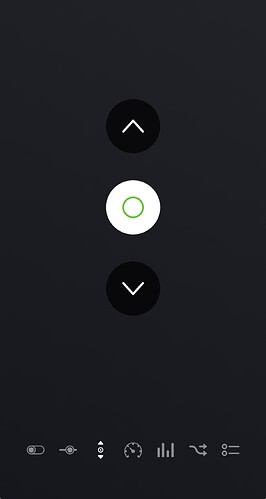

I also have shelly 2.5 for my blinds. I probably don’t understand your question, but I do it with this arrow pointing down.
The question what command the up and down arrow where in advanced flow
I have found it already and it seems to be “change state” what is confussing a I thought this meant something else
Why don’t you do it that way?
