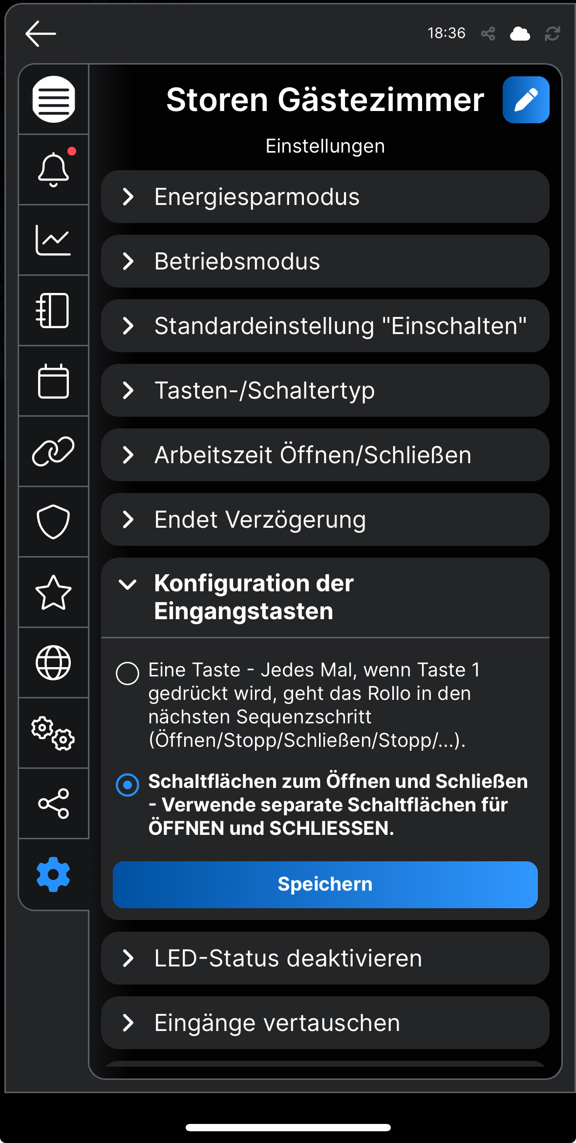

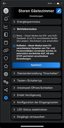

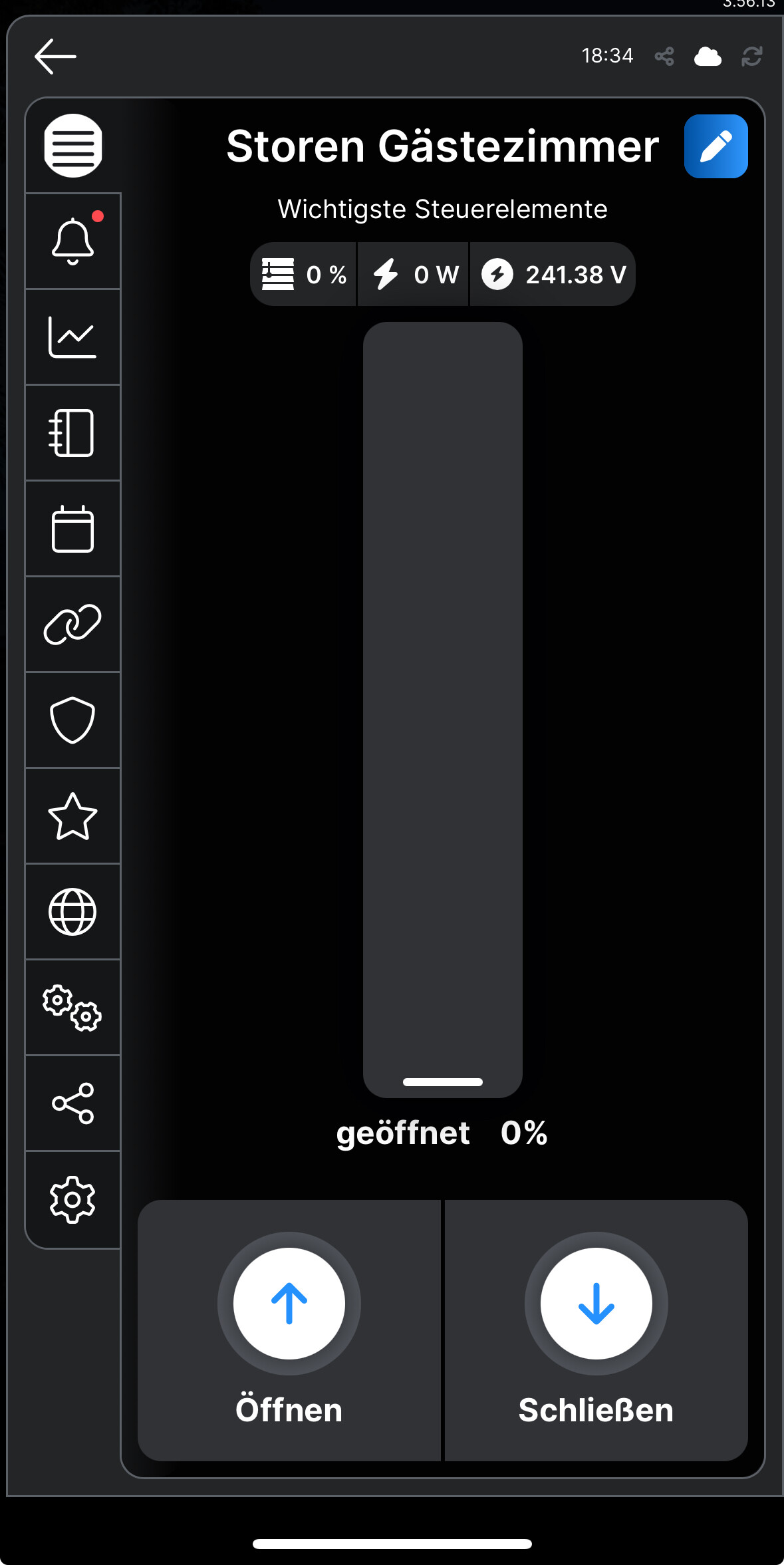

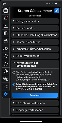

In the shelly app i have my settings like this and it‘s working perfect.
I have 7 shelly 2.5 for roller shutter…
Thx
