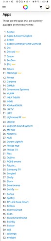

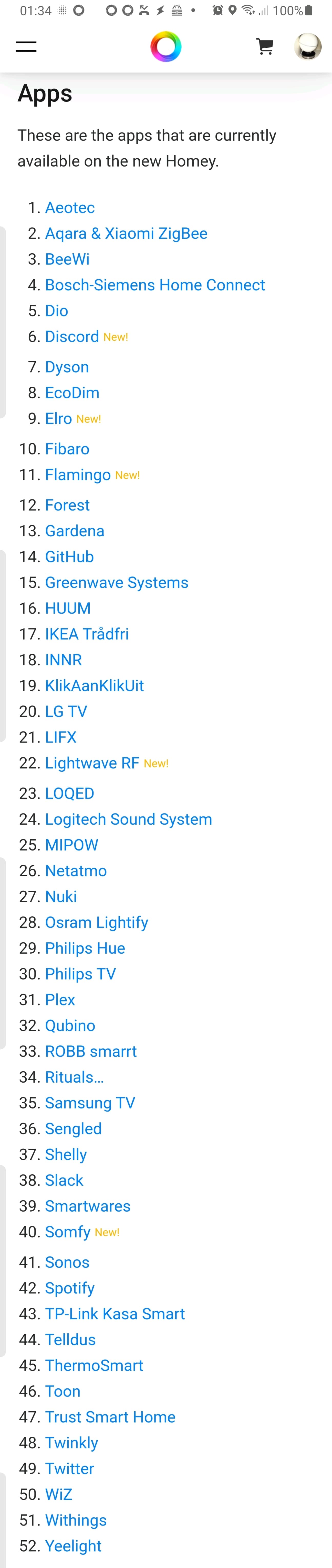

I can’t find Ring in the list of current available apps
