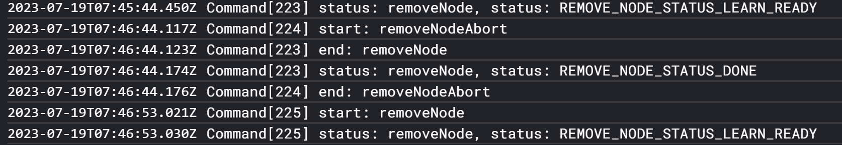

Hello Danee,
I start the ring app, learning mode for devices. Devices are not added. In ZWave log homey is activated in learning mode:
However, homey is not connecting/recognizing the devices. Other ZWave devices no problem @ homey. Adding devices in Ring app, no problem.
Thank you for your reply. Best regards, Pier
