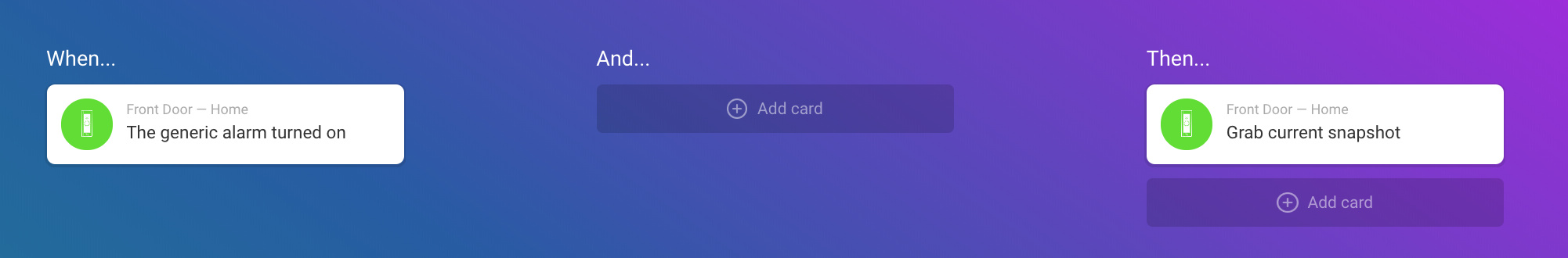

You also need the Then-Card in another (existing?) flow.
Pictures say more than 1000 words I guess :slight_smile:
I used ‘Algemeen Alarm’ because I only want an image when someone rings the door, not for every motion.

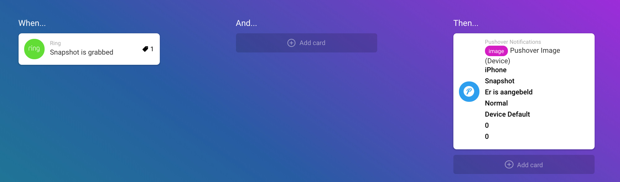

Using this:
Works great but using Pushover instead of Homeys notification.
