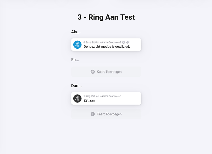

I never used Advanced programming, spagetti programming is possible, but I wrote 2 small programs. (see attachment.)
Before deleting the Base station I tried what I have done before
Using the Base station options it is working correct.
By using my Ring-keyboard to switch On the Ring Alarm it is not working, Ring Virtueel stayed “off”.
But what was happening by switching Off the Ring Alarm, my Ring Virtueel went “On” ??? How is that possible.
Then I deleted the Ring Base station.
I restarted my Homey pro.
I added the Ring Base station again
Rewrote the programs like the attachments. And tested alle my options in Alarm Installatie again.
Always using “Uitschakelen” and “Aanschakelen” of 2 programs belonging together
Nothing changed.
In the programs where I am using the Basestation possiblities it is working by using by the Basestation options, but it is not working by using the Ring Keyboard.
And also in not Advanced programs by using my Ring Keyboard switching the Ring Alarm “Off” Ring Virtueel went “On”

Am I right that the method you use to set the mode makes the difference?
To test, can you please create this flow:
After that, change the mode in the Ring app on your smartphone from disarmed to home (or away) and next back to disarmed. Please post the results visible in the timeline in the Homey app here.
Next, change the mode using your Keypad from disarmed to home (or away) and back to Disarmed again, also, please post the results from the timeline here (if any are written)

Thanks! The output shows me the flow cards work, but not as expected, the result from the condition seems to be inverted.
This can mean two things, either you’ve selected Invert on the condition card, which I don’t think is the case as the text reads De modus is Uitgeschakeld and not De modus is niet Uitgeschakeld but just to rule out I made a mistake somewhere, can you please check what happens when you right click on the card and select Invert?
The other thing, it could be a timing issue, can you please add a delay between the trigger and the condition card like this and add on and off cards for your Virtual Device:
This flow works perfectly for me, when disarmed the button is in off state, when either Home or Away the button is in on state.
(I’ve used a built-in Virtual Device, Socket type, is that the same as yours?)

Danee,
I added the flow with the delay, and now it is working perfect

This is most likely because the the fire alarm is a new capability and is at first loaded without a state. Right after initial run the capability is set to false, hence the message.
New test version published
Version: 2.14.13
  • Added settings and flowcards to Camera and Doorbell to enable or disable Motion Alerts
  • Added possible fix for a race condition where a new mode wasn’t retrieved correctly upon setting a new mode
This new test version add a setting to disable and enable Motion Alerts in the Advanced Settings of a Ring Camera or Doorbell. This enables you to have flow not react to motion detection on your Homey without influencing how other devices such as your phone wil react on motion detection.
Next to that, you can also disable and enable Motion Alerts from a flow with the new flow cards
And lastly, this test version has a potential fix for a race condition which results in having to use a delay when using the condition card The mode is … flow card triggered by a The mode changed trigger card, see this post: Ring Doorbell, Camera and Alarm support for Homey - #885 by DaneedeKruyff @Rein_Blaauw
