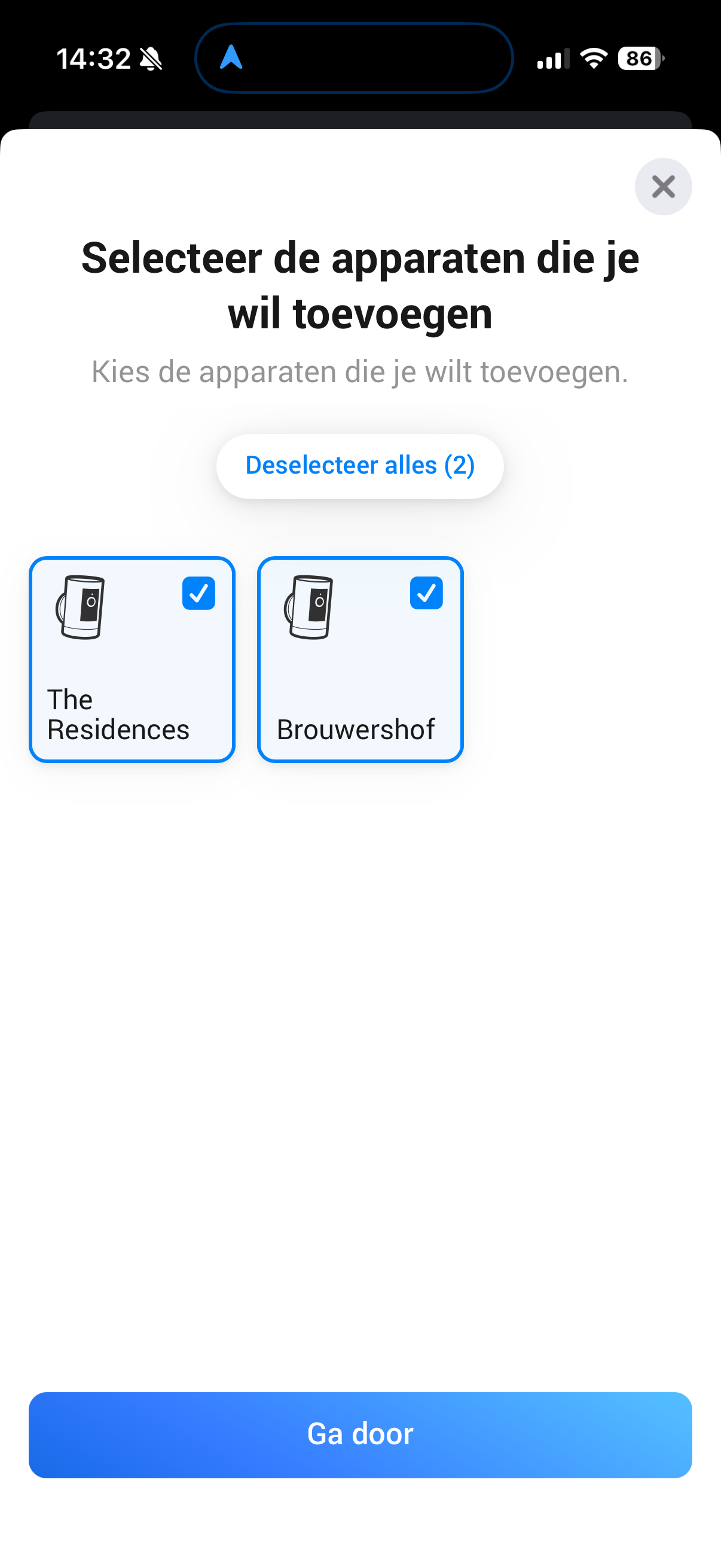

It looks the same as the ‘old’ one which is now rebranded to Ring Intercom Audio I see. Although it’s speculating, I expect the Ring Intercom Video to work, but only for capturing Ring events.

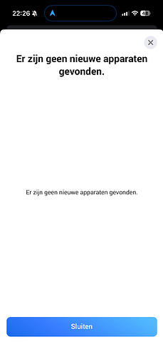

I tried but I’m it does not work…

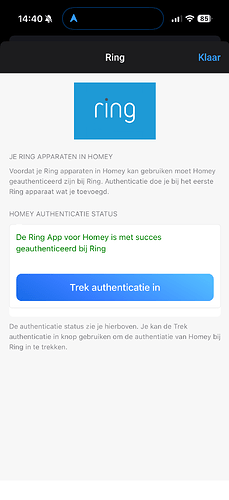

Hmmm, that’s unexpected, do you have other Ring devices, did authentication work? Can you check the authentication status in the apps settings page?
Yes, I have two other Ring devices (cameras) of which the authentication worked just fine.
Ok, thanks. I’ve sent you a PM.
With the help of @Rob_van_Ingen I was able to find the reason why the new Ring Intercom Video is not found, it was to new to be recognised as an Intercom, I’ve made some changes to the app which are now being tested.
