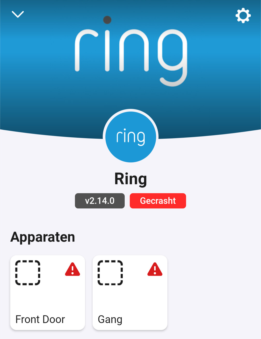

Hi.
I noticed yesterday my flows weren’t working anymore. When I checked the app it was marked as ‘crashed’.
Just had some time now to do a few tests.
  • Restarting the app didn’t work, it crashes at startup.
  • Installed the 2.14.0 test version, it also crashed.
  • Power cycled my Homey (2016 model), I still crashed.
I sent a diagnostic report, can you see anything special?

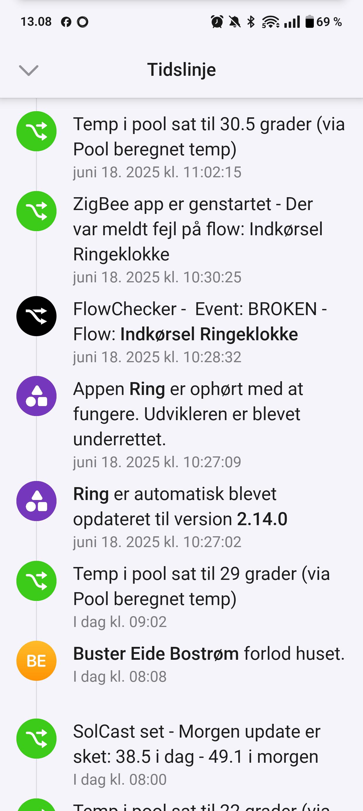

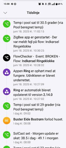

Same here - happened straight after update to 2.14.0 - No problems seen before.
Homey sent also the information that “Ring app stopped working. Developer is notified”.
Just FYI :slight_smile:

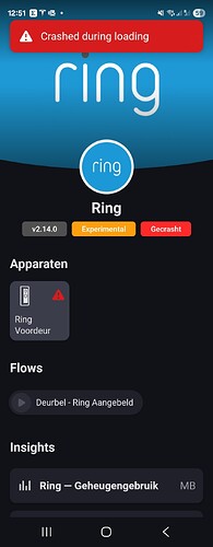

Same here, also on 2.14.0
Can everyone experiencing problems now give some more information please, so I can get a better indication where to start looking what fails, Same Here isn’t much to go on.
Please state Homey version, firmware version and which type of devices you’re using (Doorbell/Cameras or Alarm System) and if how many locations you’ve configured.
