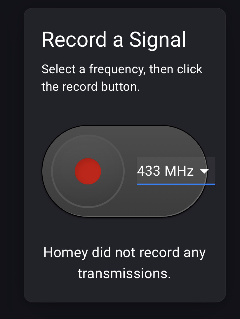

So, I’ve tried some things without luck:
  • Powered off and let it be off for 30 minutes
  • Set in recovery mode and set up again, but I could not find how to use the browser as explained here. No matter which browser I used, it just sent me to the app with no other option. Anyone knows the trick here?
  • went to the rf-section of the developer panel, and tried listening for the remote. Homey shows no signal received for either of the frequencies
Does it seem like RF module is just, and that I need to buy a new homey?
